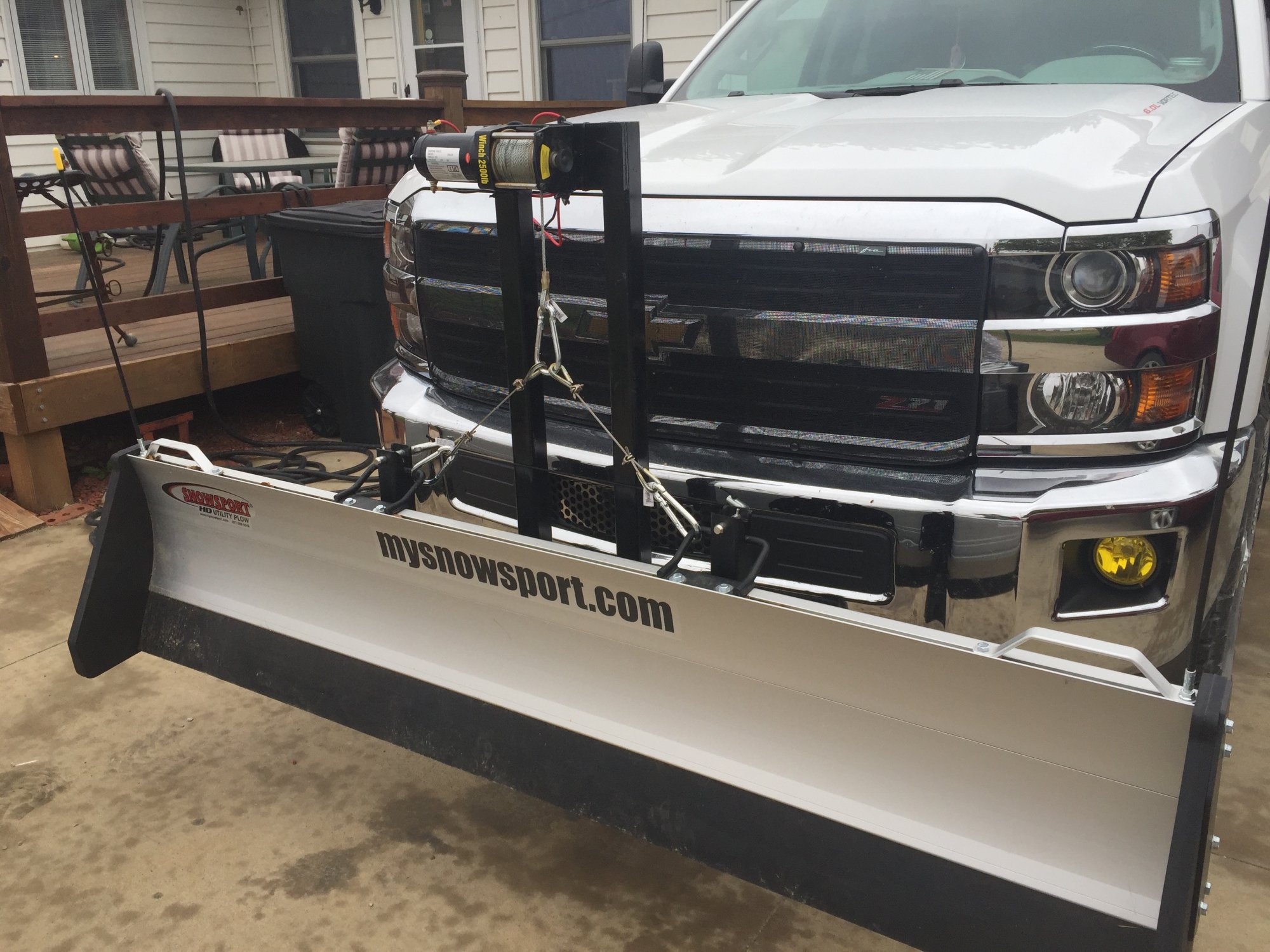

Well, depending on how much you need to use the plow and for what, you might be able to get by much simpler and cheaper.   I have a 2015 2500 that came with snow plow prep, but I really have no need for it.  I just installed  a Curt front receiver hitch and then got a SnowSport blade kit.  I improvised on the deal by having a couple of upright brackets made and a winch put on the uprights so that I can raise and lower the blade when I need to, else it just stays down for both forward and rearward.   I use it to clear about 1000' of drive, around out buildings, and even cut a path thru various drifts on my rural road two miles to the highway.  It is on it's third year now.   Total cost under $2K.  Front receiver is nice for maneuvering some small trailers around in the pole barn from time to time.
Here is what the uprights and winch look like on mine.....
Maybe a shade over 200 lb total.  The uprights are heavier duty tha they really need to be.  The blade is around 60 lb, give or take.
