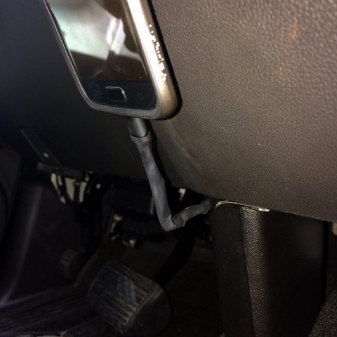

I got all the materials finally and got the cable hanger made up and installed.
Materials:
* (1) Metal hanger cut to length
* (3) 3/8" x 3" heatshrink tubing scraps
* (1) USB man
* (1) Magnetic micro-USB cable

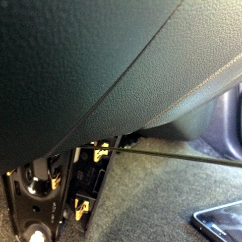

Since I was going down near the console accessory tray, there's a convenient mounting bracket that's directly below it with a few good sized bolts that I could use to secure the hanger to the bracket.
I pulled off the cover, selected a bolt to use and removed it.  I used a pair of needle nose to create an eye loop on one end of the coat hanger and then ran the bolt through it and tightened everything down.
5a59198294fee_2pullthecoveroff.jpg.681770efa21356116361b464a5faf546.jpg5a5919837cf79_3thebolttousetosecurethemount.jpg.2fbd0ef51d289bd30ef4a17f55328291.jpg5a5919800c46e_5Iusedthewrongonebutitstillworks.jpg.3325474822b117a8eb69f5efa1883573.jpg5a591980d77e3_6howthehangerlooksafteritistighteneddown.jpg.9c8977cb69a7b89f68c9a7c38695ba1c.jpg5a591981b0962_7upclose.jpg.773f8a8e25628c454aa185fa14b30233.jpg
Next bent and cut down the end of the hanger that will be near the USB jack
5a5919d87d334_8bendingthehangertogettheendnearthephonejack.jpg.d2905606c5867ad8b66fa87ebc895487.jpg
After a little playing around with the length and angle, I attached the cable to the hanger using the heatshrink tubing.
5a591b0bce5ed_9shrinktubingholdingtheusbtothehanger.jpg.4a7e22a6a53522418be74eb8e84bb871.jpg
And ran the USB cable over to the top glove box and the USB port there.  I had to use a non-powered hub so I could keep power to my dash cam going.  I feel like rerunning that or trying to tie into power was worth the cost of the hub ($3)
5a591b52b022f_10routedthecabletothetopglovebox.jpg.c1318dd0f1c1016fd0fea429e354d835.jpg
