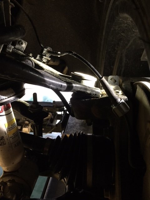

We have removed three level kits at my shop due to popping in the front steering.  Two of the trucks ended up with replacement steering racks from the dealer (warranty).  One quit popping after the level kit was removed and it was out of warranty anyway.  Last week I had a low mileage '17 Silverado with a level kit and stamped steel control arms come in with a popped out ball joint.  These are all exceptions, but I've seen enough to have an opinion of the risk.  The steering popping is annoying.  The ball joint coming out of a stamped control arm is down right dangerous.  I would not run any level kit with stamped arms after seeing this.

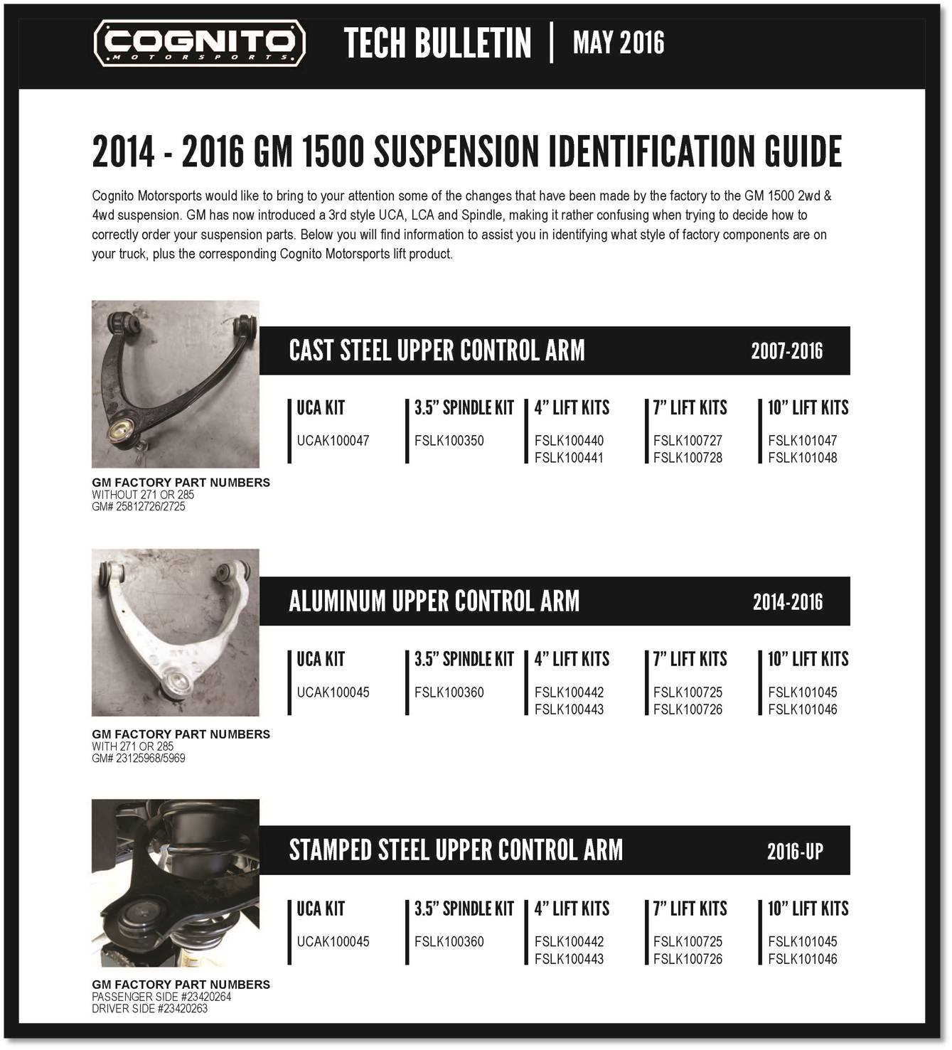

The stamped arms are quite frankly junk and can’t handle much other than stock angles. The cast steel and aluminum arms are much more robust, by far the most issues you hear in the forum is from somebody with stamped arms running a 2.5 level. 2 inches is pushing it on those arms, that’s why rough country came out with the different 2.5 kit for them and now their 3.5 kit (which is not a great kit) comes with a knuckle because these arms are too delicate.
Youll most likely be fine with a 2-2.5 kit of any kind unless you have stamped arms.

I really don't know, my best guess was increased inner tie rod angle.  There is a service bulletin on this issue, have not read it in awhile though.  The dealership service adviser in both cases knew about the level kit and asked the customer to remove it so he could help them with warranty.   It's happening with non-leveled vehicles as well but both of ours happened after the level.  There is a like a "catch" or "hitch" that makes a popping noise and feel when turning one direction.  You can see the "pop" happen in the tie rod/rack.   There is another issue with the steering column lower bearing assembly as well, it is literally coming out of place and making a dangerous catch/pop when turning.   BIL's 2015 Tahoe just had it fixed for the second time, unrelated to a level kit though.

Thanks for the info.  I have an 18 Z71 with the stamped arms and want to do a 2” level, but likely won’t do it now without replacing the stamped arms.
So tell a non-mechanic how to tell if I have stamped UCAs.   I am (was?) about to put a 1.5-2” level on my ‘18.  Thanks in advance.

much if any off-road, RC has no ETA for control arms for the Stamped Steel folk. I havent found anything cheaper than Cognito $540
