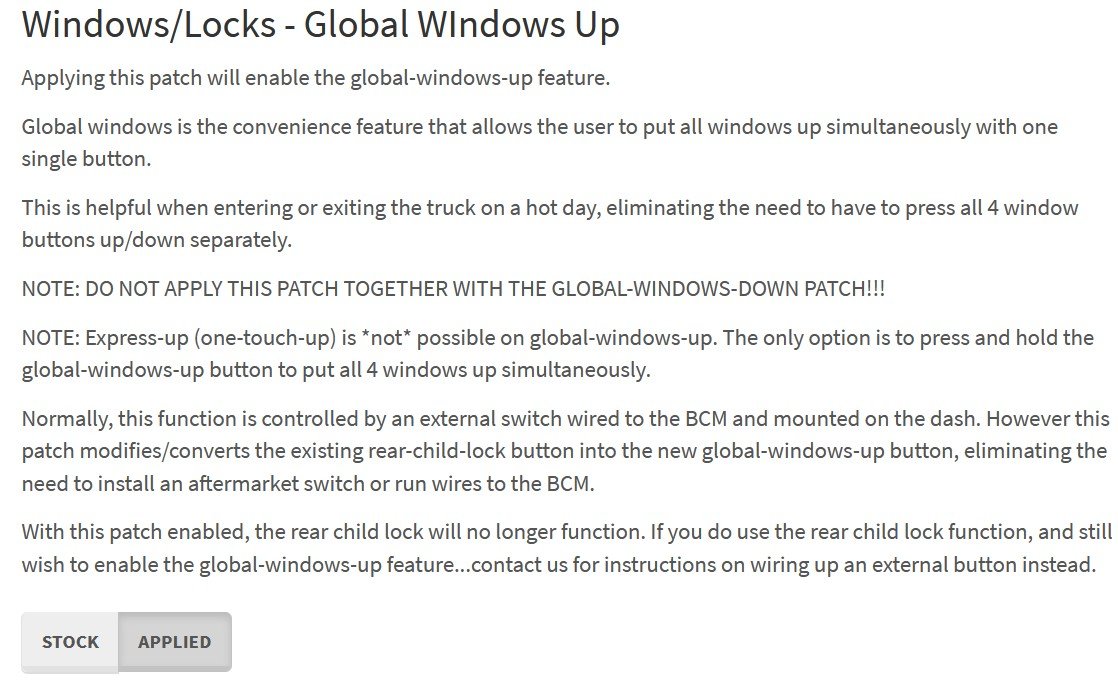

I just found a way to have DRLs stay on when turn signals are activated.
It takes an AutoSync dongle and a BTDiesel mod, but, it is possible (I just found this yesterday - so many mods on the BTDiesel and AutoSync stuff!)
Also, with Autosync and BTDiesel, one can set an all-up window switch with the child lock button.
It can, also, be programmed to all down, express, but I can do that with my keyfob, already, so the one-button windows-up was what I chose - it's not express, for safety reasons so one has to hold that button down during the process.

Well, it's not programmable without the AutoSync dongle for the OBD connector and the BTDiesel tuning (HMI and BCM unlock).
I haven't checked to see if the programming remains when I pull the dongle, I'll check tomorrow,
