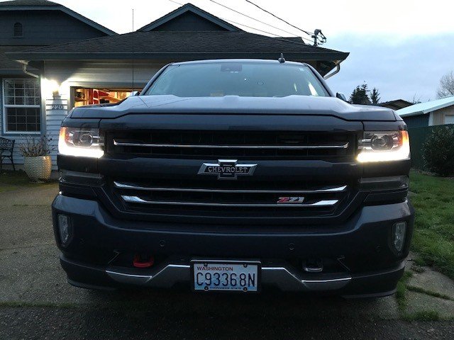

Has anyone figured out a way to keep the front Daytime Running LEDs active while also using the turn signal on 16-18 LTZ? I've had numerous people tell me I have a headlight burnt out because it disables the light when the blinker is active. I just tell them thanks as I don't want to explain what's going on:-)
That does make your turn signal more visible, my old dodge did the same thing.
Sent from my SM-A705W using Tapatalk
First time I saw it on my nephew's vehicle I almost said something to him, but I figured out.  Maybe people will learn eventually.
Welcome to the site.
This is what mine looks like when I have the park lights on:
5 hours ago, XPSer said:
Hmmmm. How did you get them this way?
Park lights on (not headlights, but will work the same) and had the hazards on. 3 pictures in sequence from top to bottom.
I like the look of the yellow LED's on the LTZ, and was asking if anyone knew how to change the "hue" from white to yellow when the lights were on, no luck.
  • 3 weeks later...
Those are LTZ headlamps. LT and the rest have a halogen lower element.
