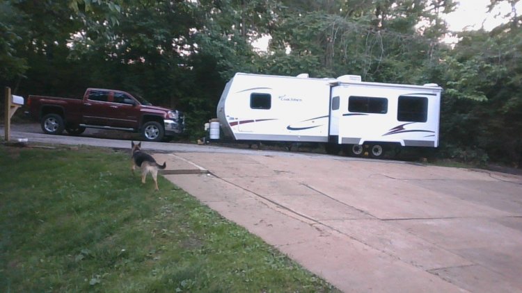

Good evening all,
Heading out in the morning to Moab, Utah from St. Louis, MO and wanted to get some feedback on towing. I have a 29' travel trailer I'm taking that weighs 8000 LBS (fully loaded). From the manufacture the tongue weight is 710 LBS. I also want to take my 4x4 (05 Honda Rancher, weighs 498 LBS).
Does anyone see that being too much weight or anything else I might be missing.
Quick BIO, I'm a longtime truck owner and very mechanically inclined, but this is my 1st 3/4 ton (2015 Sierra 2500 SLT- 98000 miles) and this is my first time pulling a camper this far.
I really appreciate any and all tips, suggestions (good or bad), & advice.
Thanks in advance
Clem

If it’s a 3/4 ton truck, I’d say you’re fine. Just make sure you have your trailer brakes set right and watch your trailer while towing. If things get squirmy, empty tanks like mentioned above to cut weight.

You have a 3/4 ton. It should handle that weight no problem. The 6.0 will want to rev 4K+ RPM on hills. Enjoy the small block sound and have a safe and fun trip!
Great info guys. Defiantly taking it all in. I do have a WD Hitch and just pulling the trailer I cant hardly tell its there. The fresh water tank was the only one I was going to fill, but might just take the advice from all and wait. Not too worried until I hit New Mexico. from there should get interesting going in the mountains.
Was gonna say you were crazy with that much payload on a 1/2 ton but then continued on and saw you have a 3/4 ton. Im guessing youre payload capacity is in the 2500-2800lb range? You will be fine. Have fun.
I was thinking when I read the title: great another 1500 guy who thinks he has a HD truck but, I would think you'll be fine: add up your tongue weight plus the weight of your cargo and as long as you're under the payload listed on your truck you're good to go..
