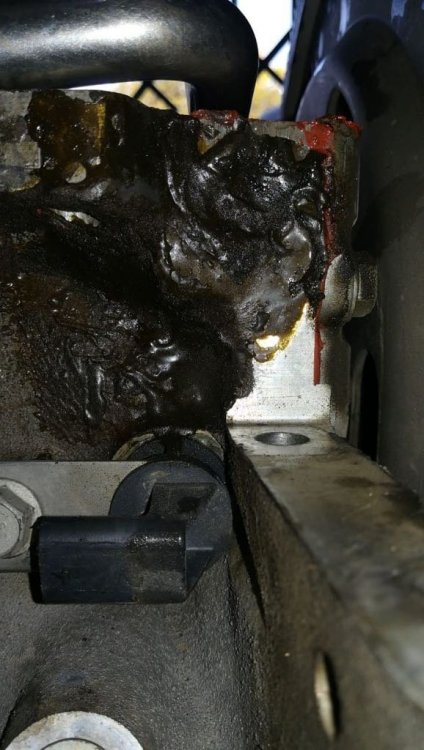

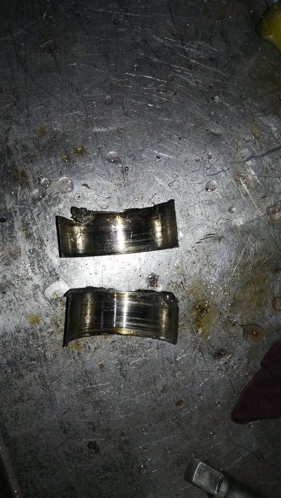

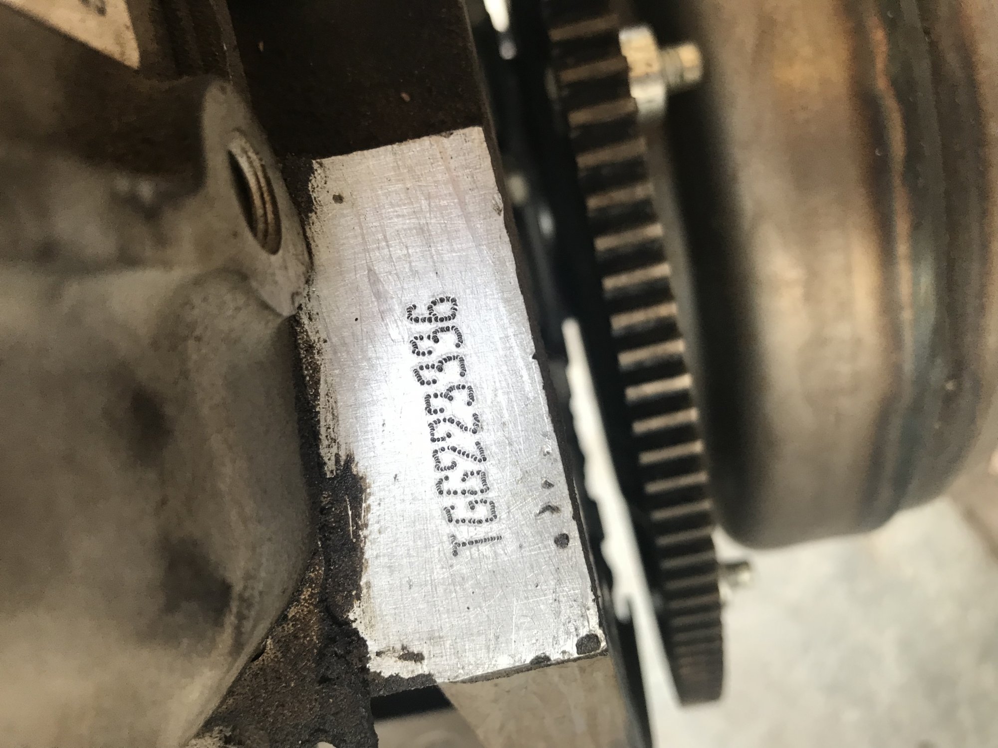

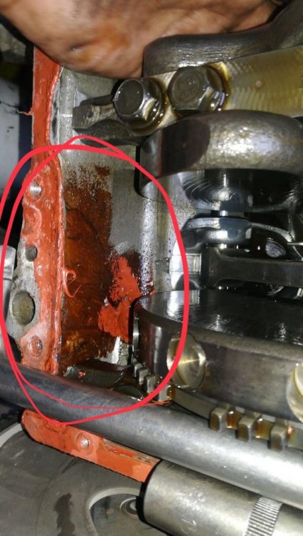

Hello all !!! I’m new to the forum need some information regarding a GMC Sierra Denali 2016 that I purchased in Dubai In May 2018 I checked the car thoroughly it didn’t have no problems.The car was exported from Dubai to Pakistan where GMC is not officially present.I drove the car 500 km’s and the engine ceased at 37000 km’s after pulling the engine out an independent mechanic at a workshop discovered that the engine was repaired due to a severe leak in the block towards the flywheel which could not be seen from underneath the car during inspection but there was something more strange than that the engine identification number seems to be tempered I’m gona post a picture of it,if someone whose seen the block number on their engine can let me know if this block number is factory stamped or tempered.I’d appreciate their time.
That appears to be factory style numbering.  Someone has definitely been in that engine before.  GM does not use orange silicon sealant and when they use sealant, they don't use huge gobs of it.  That appears to have been patched up and shipped out from a less than reputable source.  I hate to say it, but you got screwed.
Thank you for your reply I’m not sure if the numbering is factory style as I’ve never owned a GM vehicle prior to this i hate to accept it but that’s what’s happened some one has definitely been there its badly damaged I’m in talks with the dealer in Dubai to get me a replacement engine if he doesn’t agree I’m gona file a complain against him for fraudulent case.
Crimson sorry for your troubles.  Someone did try to band aid fix a major issue with the engine.  Silicone used is not the correct type used by the factory.  Was there some indication such as tapping or knocking before your engine seize?

There was no knocking or tapping the engine lost power suddenly it shook for 2-5 minutes  under throttle and then seized at first I thought it was the battery or perhaps the starter motor but it turned out to be a major issue I’m hoping to get it fixed ASAP as I love the truck but this issue came too early I barely drove it I'm in contact with the dealer in Dubai hoping to get a replacement engine.
