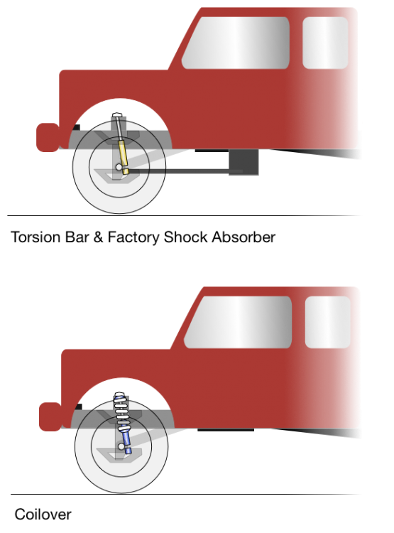

    Hi,
      If you have torsion bars up front, then there is no need to read this post any further.
      If you have coil springs in the front:
      A customer came to me once with a nearly Brand New Nissan Sentra. They had a weird popping sound coming from the front end whenever you would make fairly sharp low speed turns. Les Schwab had diagnosed it as bad struts, and replaced them both from about $800. The exact same popping sound came back the next day. It took about 2 minutes to diagnose. The upper part of the coil spring was slipping against the upper spring seat. As the wheel and strut turned, it would put rotational forces into the spring, and the top of the spring would go "pop" "pop" "pop" as it jumped to the next position rather than smoothly slipping against the seat. Then when you turned back the other direction, it would do the same thing.
    There are a few simple options available to fix this problem.
  •     Spray the upper spring seat with a little WD40 so that it will slip smoothly and eliminate the noise.
  •     Apply glue or sealant to the top of the coil spring to prevent it from slipping against the seat.
    Les Schwab charged these people $800 to not fix the problem. I charged them $0.00 to diagnose and fix the problem.
    If you have springs up front, hopefully that will solve the problem. If you have torsion bars up front, and you are still reading this, sorry to waste your time.
    Either way, good luck on your repairs.
