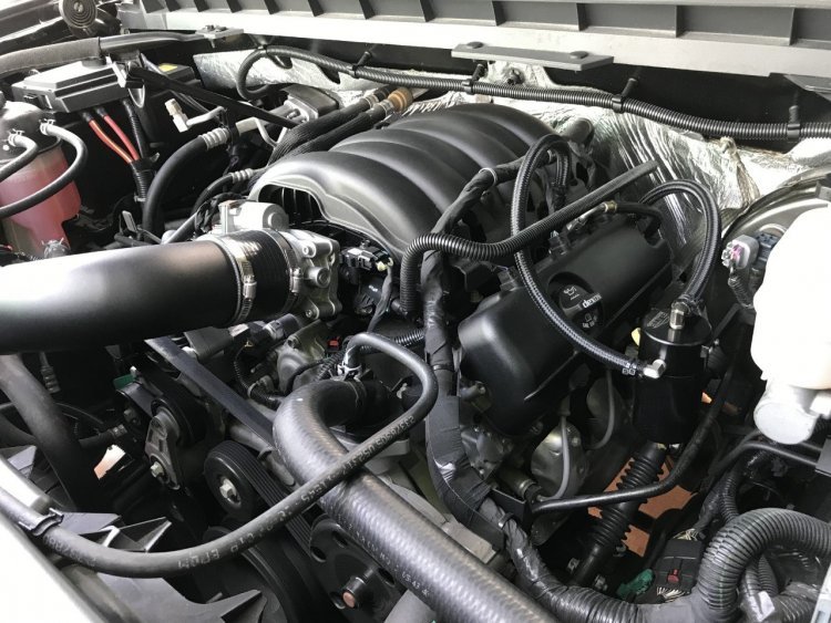

I have done a few mods to mine and it feels at least as quick as all the 5.3 loaners I have driven since then.Stock for stock the 5.3 honestly barely felt like an upgrade so that isnt really saying much.Truth is there anything " significant " that can be done to an already high strung naturally aspirated engine while keeping it suitable for truck use.A few guys have tried boosting them but there just wasnt enough fuel to make much power with them.Here are some non-intrusive things I have tried which had a positive effect on the 4.3 in case you catch the mod bug
E85 gas
JET maf
Range AFM
Overkill  TB
K&N intake
Gutted 3rd cat
Muffler delete
Which tb did you use ?

Its the 80mm throttle body retrofit Overkill Motorsports sells for the LFX 3.6 engine.Its basically the stock unit from a 5.3 with an adapter spacer but it will feel more responsive on the 4.3 because the built in throttle delay is less sensitive.Another thing I added was a catch can from Elite Engineering.Here is a photo so you can see how the throttle body and catch can look.
