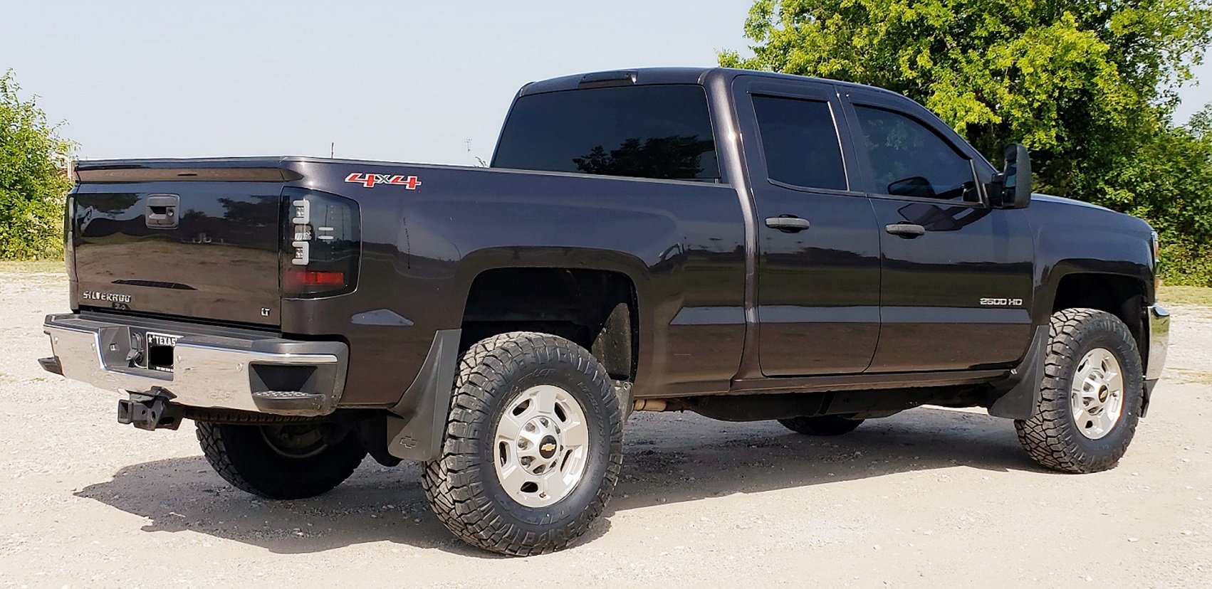

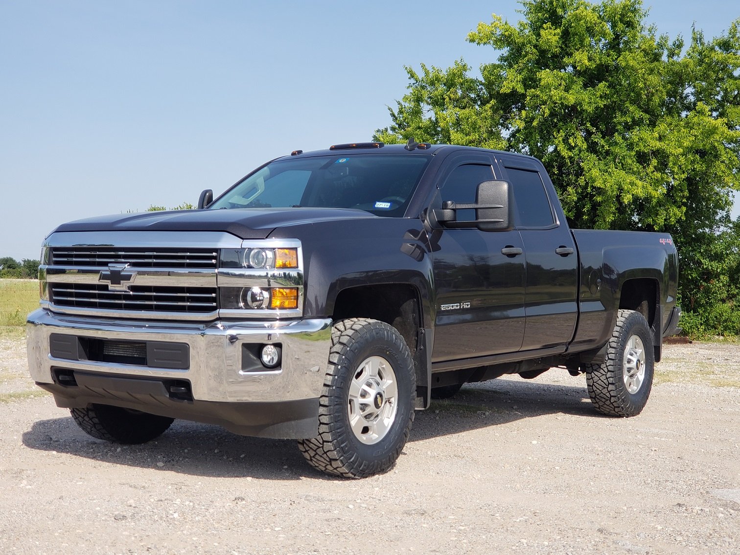

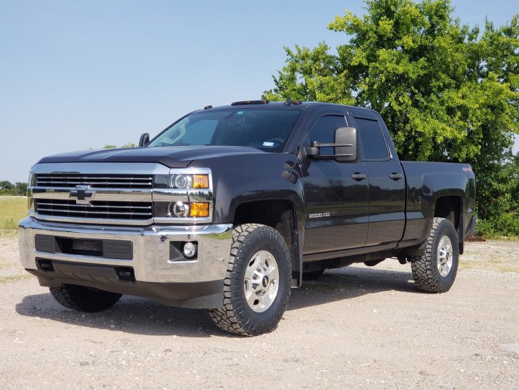

I have 17's but was in your situation about a month ago. I knew I wanted to go bigger, but didn't want to deal with the issues that go along with going too big. I ended up going with 285/75 17 Ridge Grapplers, cranking on the keys a little and getting it aligned and have been very happy. I got the increased height I wanted and most of the width without any problems. The pics below were taken before adjusting the keys - it looks closer to level now. All these trucks seem to be setup a little different, so for whatever reason, what rubs on one may be fine on the other. Best of luck.
