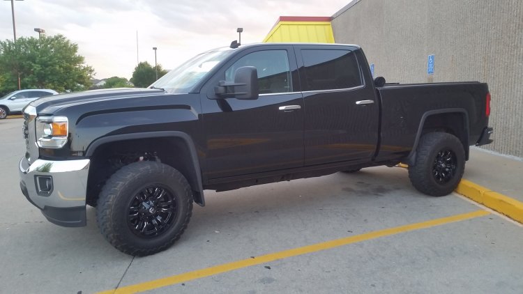

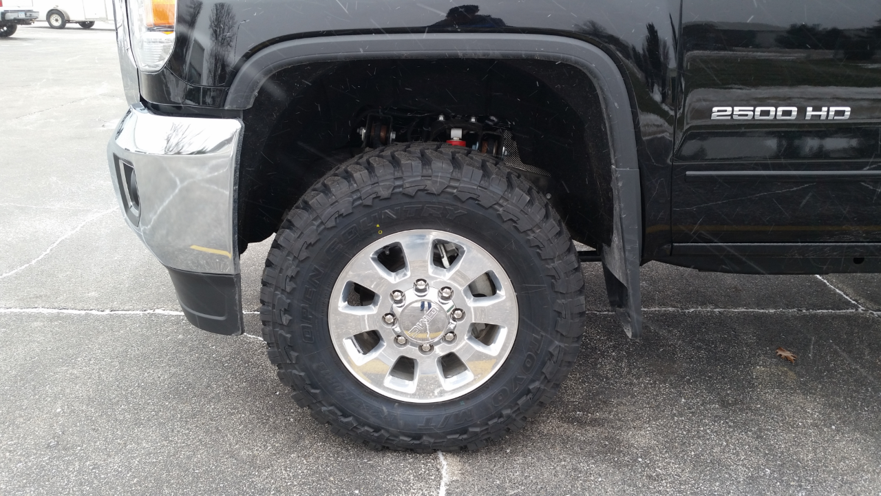

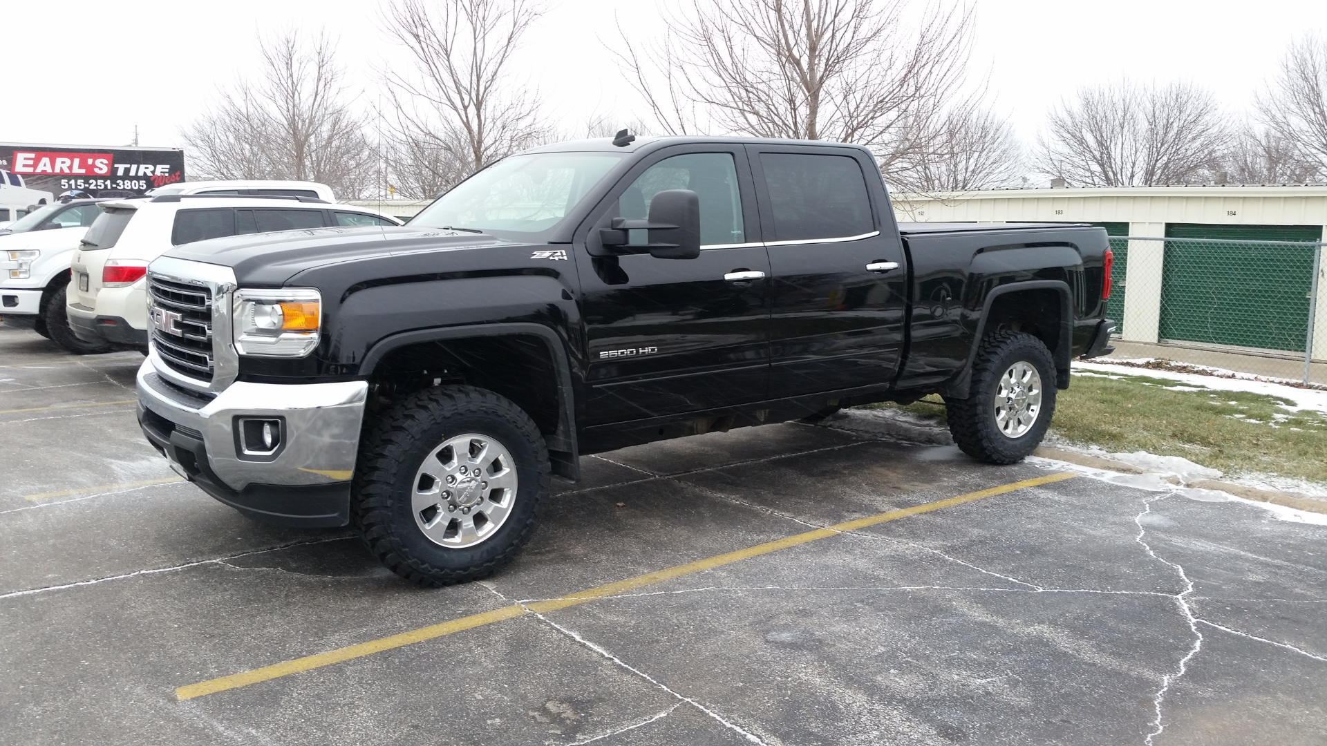

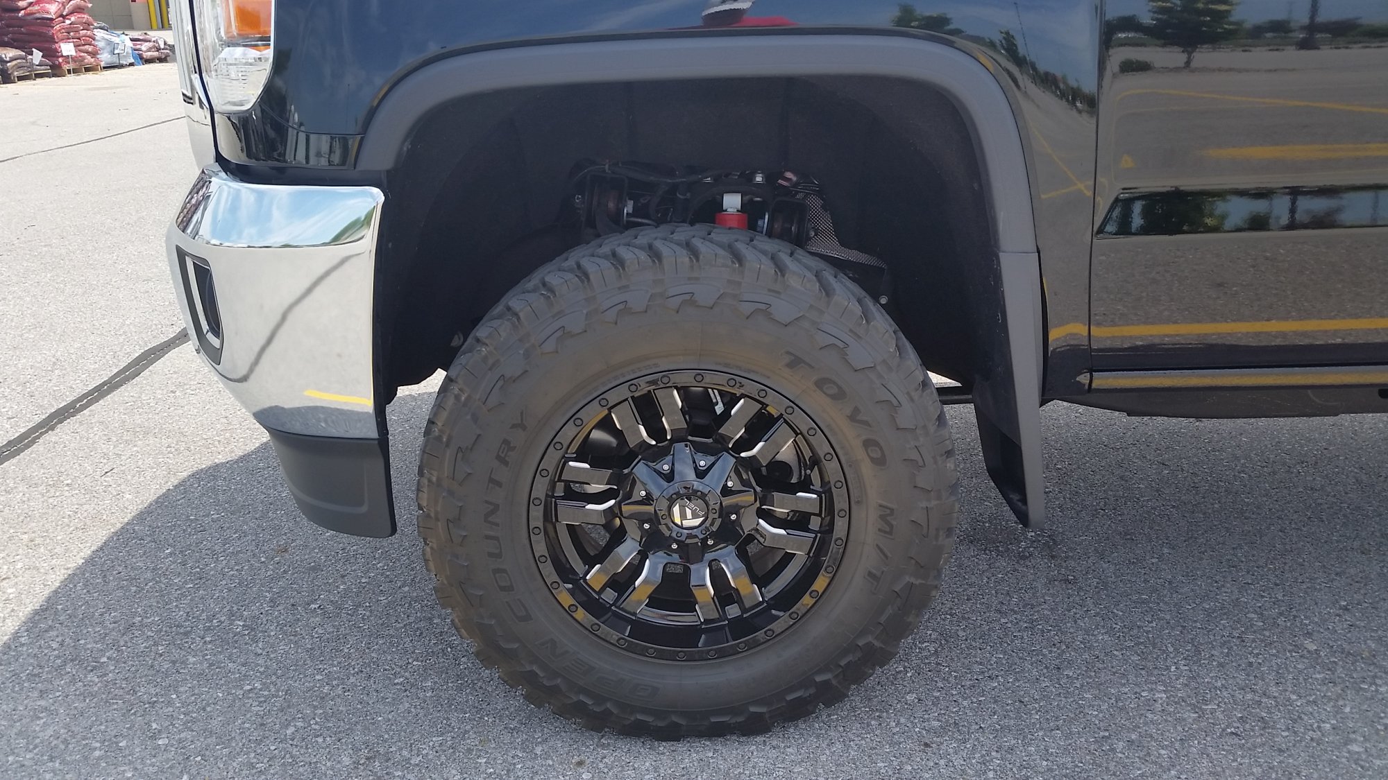

I have that size on mine. 18x9 +1 offset wheels. I cranked the front 2in and they fit fine. No trimming at all. I even have mud flaps. If you left stock wheels on you wouldn't even need to crank.
Dmaxnaz,
Thanks for the response, your truck looks great!  How did you accomplish this, did you just crank up your keys in the front?  Or did you replace them altogether?  Also did you utilize any blocks in the rear?
If I did it all over I would have left the 285's on the stock wheels and lowered the rear 2 inches. I would have left the front stock.
