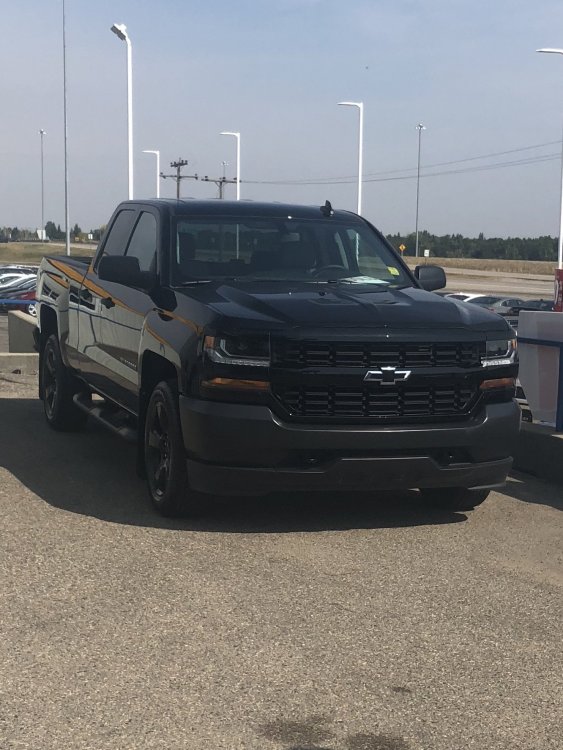

Hi guys,
I’m new on this forum, as far as posting goes, but I’ve found some amazing information, so I’ve decided to share my new truck.
Its a 2018 Silverado WT Blackout Edition 5.3L.  Had it for just over two weeks and it’s a great truck.  Used to drive a 2015 BMW but it was getting hard to pickup 2x4s in it.
This is the first truck I owned and initially I wanted to purchase a used one (2016-2017) but the discounts and 0% financing on the 2018s was too much.  Most places here offered 4-6% financing on used trucks, which over a few years means thousands in interest fees.
I went for the WT model because it came right under my budget of $40K.
So far I’ve had the following added to it:
Linex bed coating
Tyger Bed cover
9-piece Bullring set
Husky floor liners
Ez assist for lowering of tailgate
I would also like to add a remote starter before our winter sets in but I haven’t found enough info on whether the GM stock one will intergrate with OnStar so I can star it with my phone.

Congratulations on the truck man! Looks SHARP! :thumbs:

Thanks man!  It’s the only vehicle I bought and no buyers remorse.
