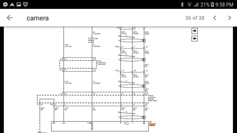

I extended a second oem camera tht i use on back of my tt. There r 6 wires for my year. 12v +, -/ camera + n - / reverse+ n -. U can take any aftermarket camera and splice it in, some does make a adapter for aftermarket. Only quest is how to mount in tailgate.
Sent from my SM-G935P using Tapatalk
Yellow wire is camera +, brown is camera neg. Red is 12v+ and purple is reverse 12v+ if i remember right. The 2 grounds are not seperate, they splice together in the harness to 1 black wire.

Let me know if u find a good 1. I already made the plug to hook up to the distribution block, only thing i would have to figure out is just how to swap out the camera.

My test camera arrived today.. size looks good. Where did you get a spare plug from to make another cable? I would prefer to keep the OEM camera/wiring intact
Order from digikey online. U have to order the pins to it too
