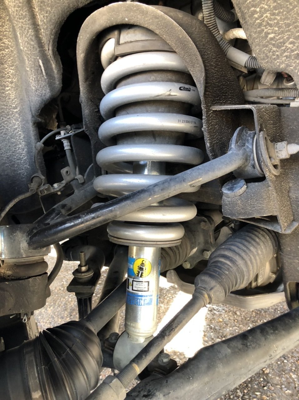

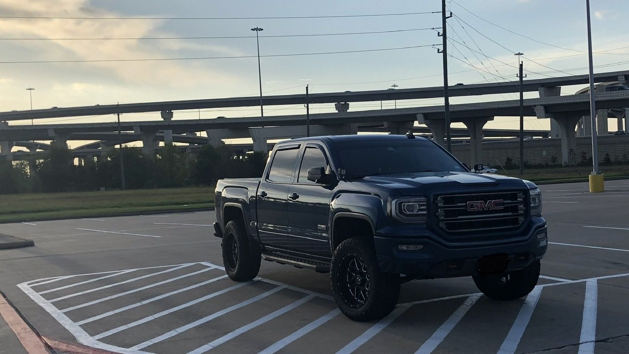

I actually went a different route with my lift, I ended up taking the lift spacer off and adding a set of Eibach 2.5" lift springs.  I set the Bilsteins at the 2nd notch, and that gave me about the same amount of lift as the Superlift kit.  I went with that setup for a while before trading the truck in a couple months back.  The upper control arms and diff drop were looking great before letting it go.
So my lift "kit" was actually: Bilstein front struts on 2nd notch, Eibach 2.5" lift springs, 1/2” Motofab spacer, Superlift control arms, Superlift diff drop, and GM metal skid plates.
Rear setup was 2.5” lift blocks and Bistein 5100s.  (I had planed to change this to 3" or 3.5", but never got around to it)
I ended up using a 295/60r20 tire, truck looked awesome.

Dude You aren't lying. That thing looks absolutely perfect! Just the right amount of lift.
Just a couple follow on question if you don't mind. -
Assuming the second setup with the eibach's and no spacer was an overall better ride?
Any negatives with the first lift (full superlift w/spacer) that I should be aware of if i went that route?
Looks like it sits right at level, is that true? I'd definitely prefer a slight rake to being nose high at all.

The suspension was a little too stiff for my liking, but I felt like the 3.5" Superlift spacer was over extending my axles at full droop.  Never had any issues, but it seemed like a bad angle at full droop.
Yah with my final lift it was perfectly level, which is why I wanted to go to a bigger rear block to get some rake back.

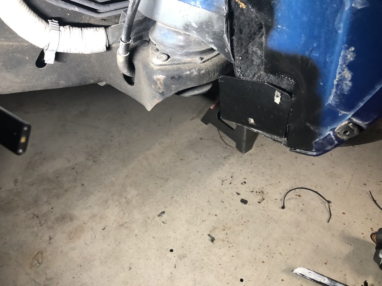

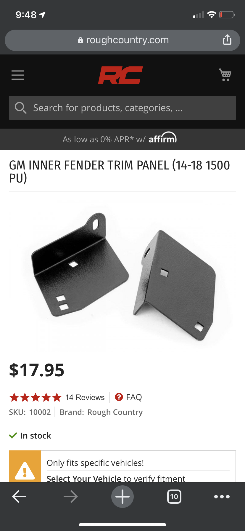

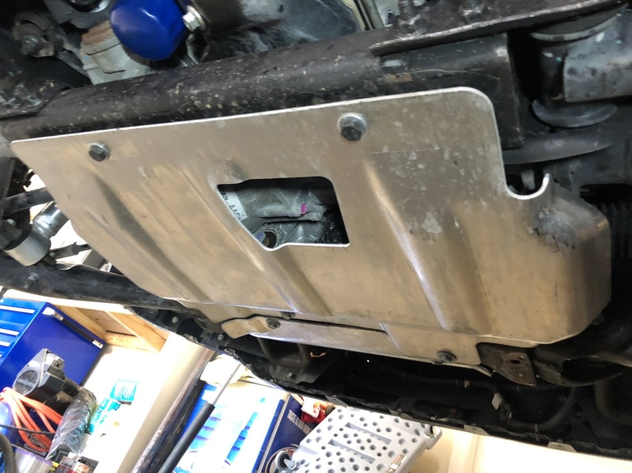

Yes the 295/60 rubbed, but that was because I had a 10" wide wheel, you'd be fine with a 9" 0 or (+) offset.  I ended up doing a norcal mod to stop the rubbing, it worked perfectly with these plates.
