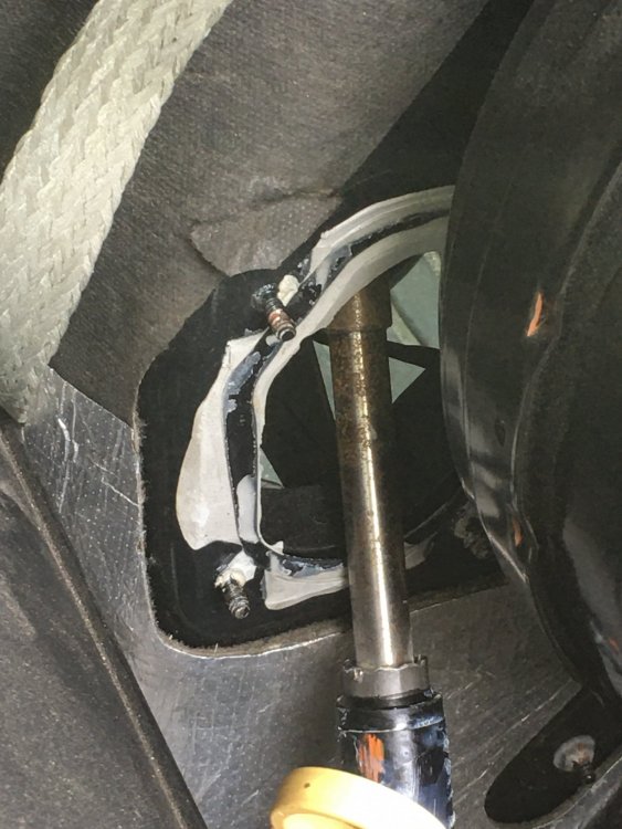

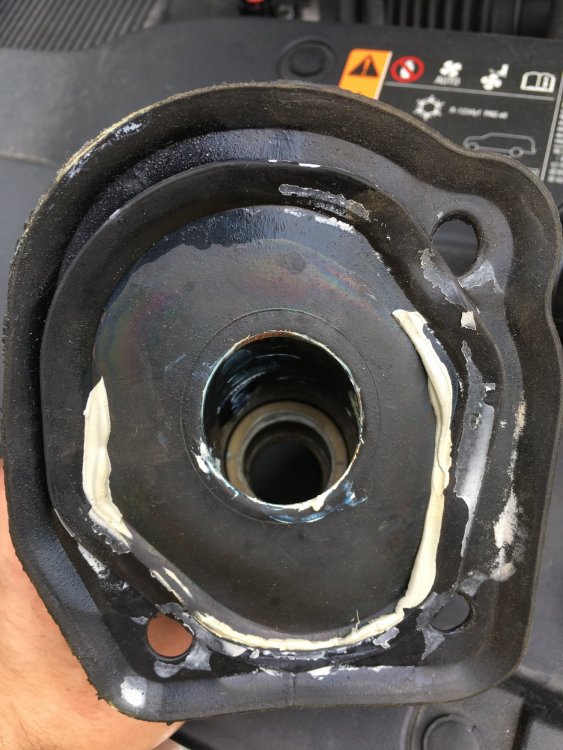

On 5/8/2019 at 9:42 PM, lapoolboy said:
I gave up on my idiotic dealer trying to solve this issue and just fixed it myself.
Take the rubber boots off the firewall with three 10mm nuts.  Disconnect the steering shaft under the brake master cylinder and separate so you can slide boot off.  Apply rubber-safe synthetic grease (I used Sil-Glyde) liberally between the plastic rings inside the boot (you'll see them in the narrow end, distal to the firewall).  Reinstall boot and wipe off any excess that pushes out onto the steering shaft.  Enjoy your now flutter-free truck!
My dumb ass dealer solved nothing either.  I just ordered some sil glyde per your advice. Do you know what the bolts on the steering shaft need to be re torqued to, as I’m going to try to do this Sunday.  Ty for the help poolboy
