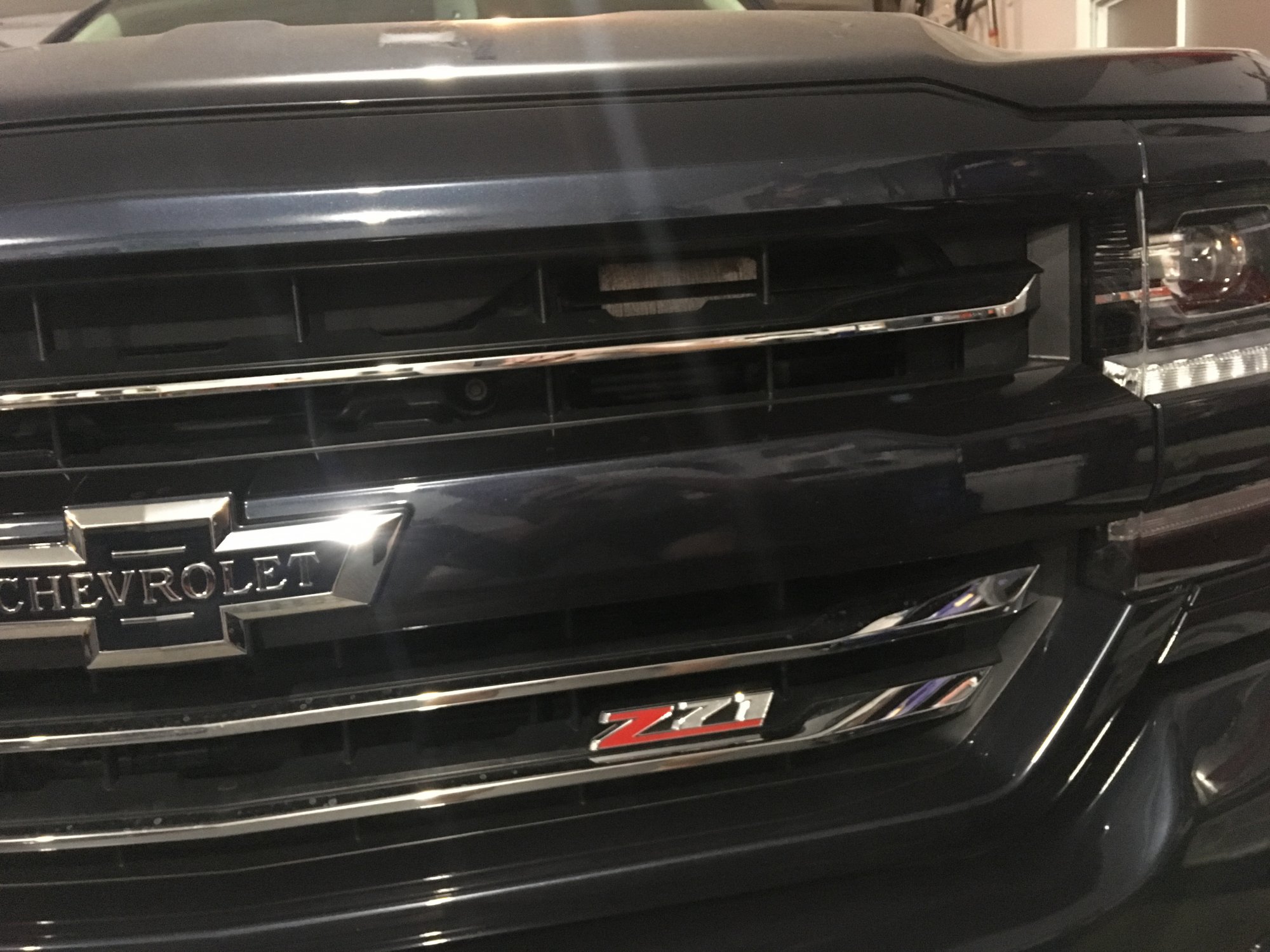

Any Idea what this is?
For the life of me I can't figure out what the shinny piece of tin foil is - by the right upper portion - behind the grill.
Perhaps something to do with the high capacity air filter????
Its right in front of the rad.....
Strange. Mine is a piece of plastic and on both sides.
Sent from my SM-G965U using Tapatalk
I got the foil thing too. [emoji1742]‍[emoji3603][emoji1742]‍[emoji3603][emoji1742]‍[emoji3603]
When I had my AC condenser replaced, the new unit had the same tin foil square in the corner. I asked the dealer service tech what it was and he said it was a shield to protect that corner of the condenser. That corner is frequently where the condenser leaks from when it fails and the tin foil is GM’s fix.
Thinking about it, I’m not sure the foil acts as much of a shield from road debris as it acts to block airflow and rapid cooling. My guess is that corner is a stress point and the cooling and heating cycles of the condenser eventually cause fractures. The foil would act to reflect some of the heat back and blocks airflow from cooling it too quickly.
Nice looking truck...I'm liking those Centennials more and more...
black tape!!... i have a black plastic piece on the passenger side behind the grill...
To confirm, it is to protect that area of the condenser.
Just shoot a quick burst or two of some flat to satin black spray paint on it and Voila!
Good looking truck! Those chevy engineers, can't see why they would highlight that. Then again!
I agree with the other posters. Mask it off, blast it with flat black paint, and try to burn the image from your mind.
