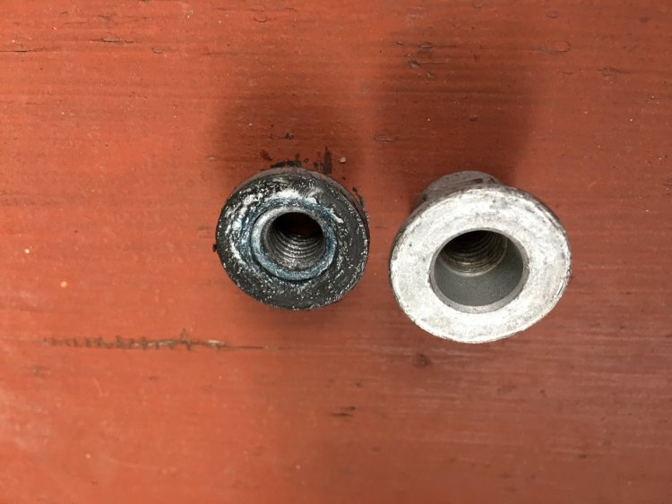

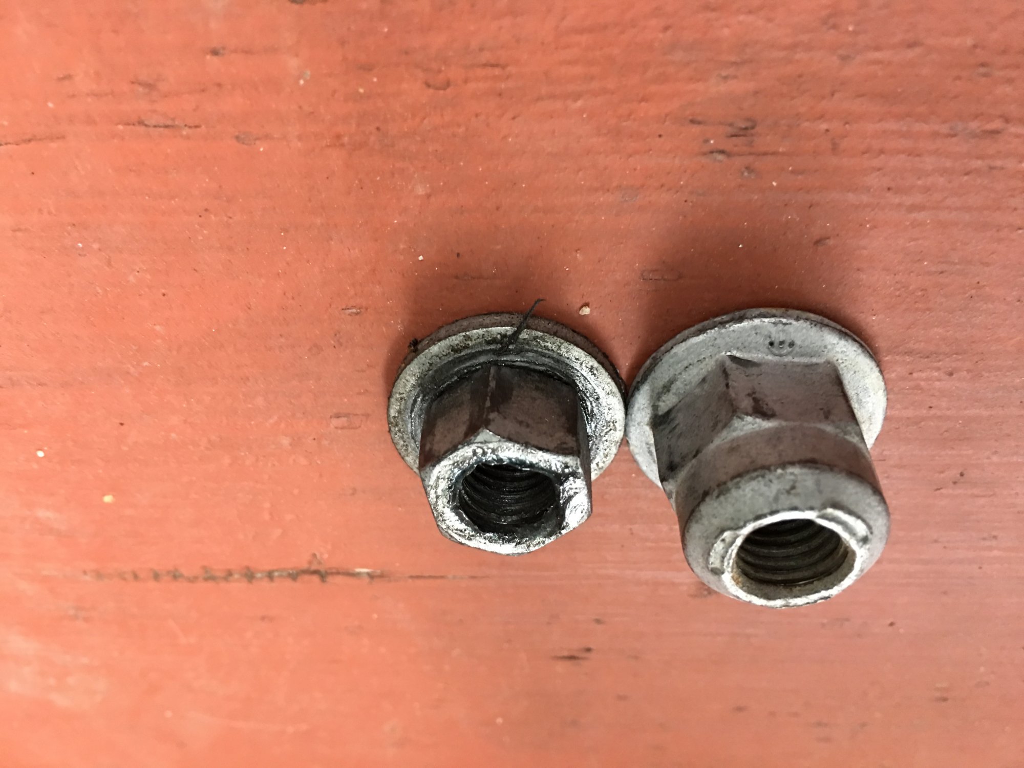

Yes, after a few months I was getting slight clunking on bumps. Tried tightening supplies nuts and they were tight (bottomed out in strut thread). Installed factory nuts and its been quiet since.
right on I remember seeing a thread or video on YouTube while Googling on the internet about the clunking sound knocking sound up front on our Silverados. The guy actually use a couple of washers that fit inside. He showed exactly where the strut rod was hitting on the mount plate. Adding some washers to the cup did the trick for him. I'm likely going to do the same as I noticed exactly what you're speaking of if you think about it there's not very much tension on the top cap as you tightened it down while the vehicle was not up on jack stands. This allows it to move around and create that knocking sound. Since I just put mine in last night I don't mind having to take the top nut back off and put washers on it.I think that should be something everybody does when they install these.sadly the thread on the strut rod isn't that just not long enough could be maybe a another 2 eighths of an inch to be effective and solid.

If you look at the stock nuts the threads are 1/2 inch or so at the top of the nut so there’s less risk of bottoming out or acts like washers vs the bilstein nuts.

I just uploaded some photos to the previous post ?
I just uploaded some photos to the previous post [emoji106]
That solves it! Rock on!
