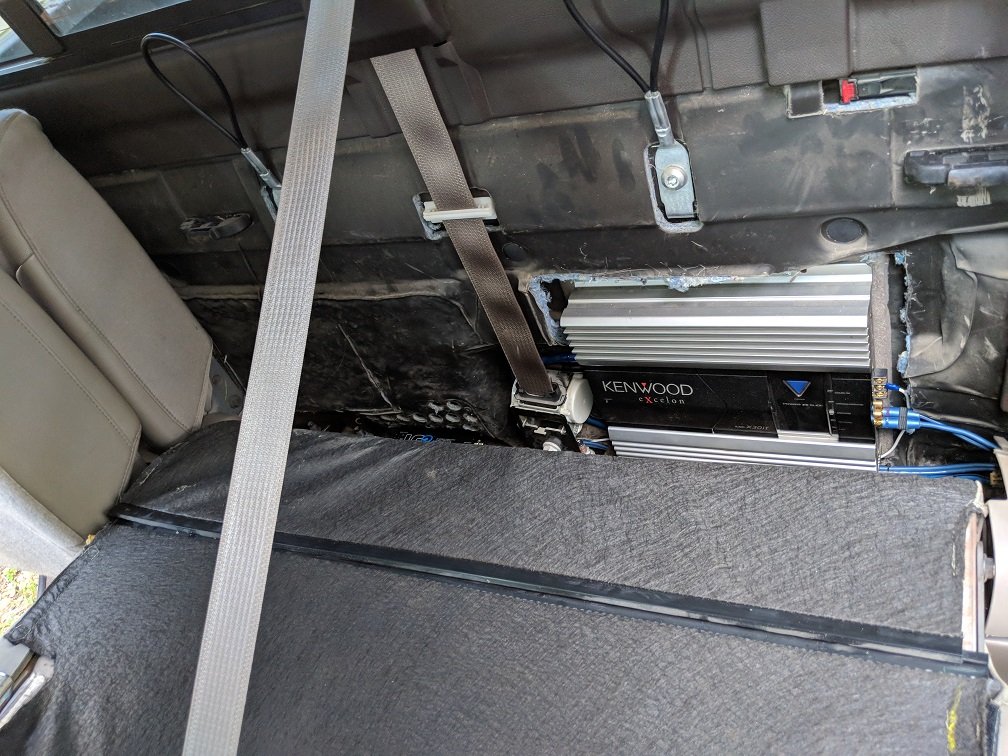

anyone done this on their crew cab rear seats ?
I have. I did this to m first set of seats. Haven’t done them again on my new set.
Interested in feedback as well.  Seen this before but have been on the fence.  Mostly I'm curious how people are using this mod versus just having the seats folded up.  My one concern would be that the seats would want to fall down all the time.  Say I have my seats folded up to put some groceries or whatever in the back.  Wouldn't the seats then fall down all the time?
I did this. It works fine. Kind of wish I would have cut a little less off than what I did, but not for any good reason other than I don't think I need to cut that much off. It works fine.

The seats stay up when folded up still. The detent that holds the lower seat up holds it in place.
Well that does it, I’ll be doing it hopefully this weekend. Thanks truckmann for the pic on how much to cut off . Your seat stayed in place while in the seating position yea ?

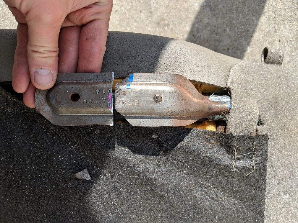

Hey man, just curious why you didn't do this on your second set of seats. Also, did you get any rattling noises from the rear seats once this mod was complete?
Didn’t have the time (at the time). I couldn’t remember how much of the bracket to cut off (lol).
No rattling - But several times, the rubber “boot” that goes around the metal loop fell off. So when I get around to doing it, I’ll be to zip tie that sucker on the loop. What ends up happening, is that that you lift the seat bottom up, it lowers the bracket enough to clear the loop (so you can fold the seat down). So when it comes time to fold the seat back up, the metal bracket can catch the boot and pop it off. That rubber is what keeps the brackets from rattling on each other. Mine never rattled (when the boot was off), but I suppose on bumps and stuff, it could rattle.
2192861d2fed3479ee789e268d25e362.jpgLike this pic, I couldn’t find at the time. Lol.
is the cut mark the blue or black mark ?
Black. Sorry. 2 1/4” off.
I cut 2 1/2 off from mine and they still lock in place just fine. I personally did it to have access to my amps.
