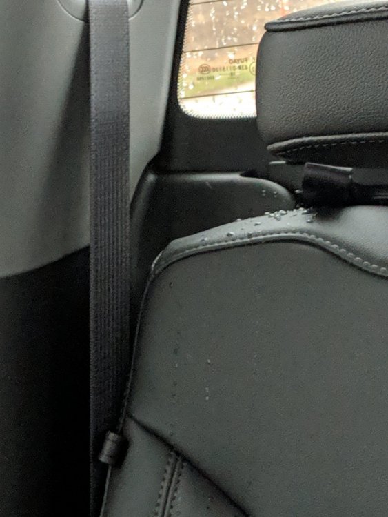

Yesterday I was welcomed to the party guys.. I hope they can fix it. I'm having a hard time with my dealer giving me a loaner, said May 2nd at the earliest. I'm working with GM to find a dealer with a loaner. Any other tips and getting this stuff fixed?
Try and keep me it out of the rain. Maybe put a towel at the top of the rear seats behind the headrest. The last thing you want is for it to soak into the seats and carpet. Then you'll be dealing with mold/mildew smell like I'm going through right now.

Both sides of mine are leaking and it soaked the headliner yesterday on both corners.

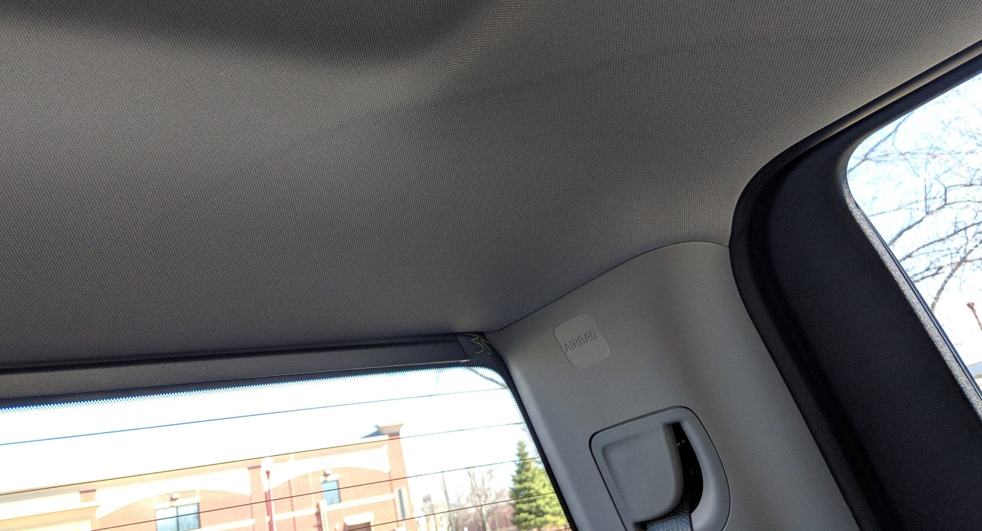

What does your roof headliner look like? Can you see water stains from it getting wet previously.

The only stain I see is from the one the other day. This is what it looks like now.. I had the truck in the garage with a large fan blowing on it all night.
They will have to order a new headliner which means they will have to remove the front windshield to get it out and the new one in
