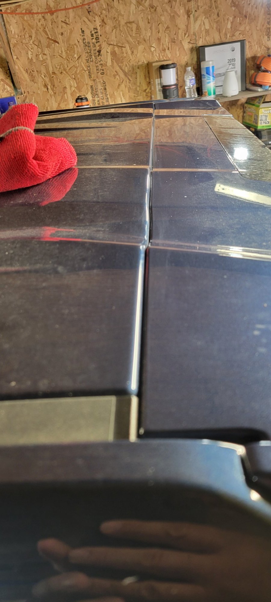

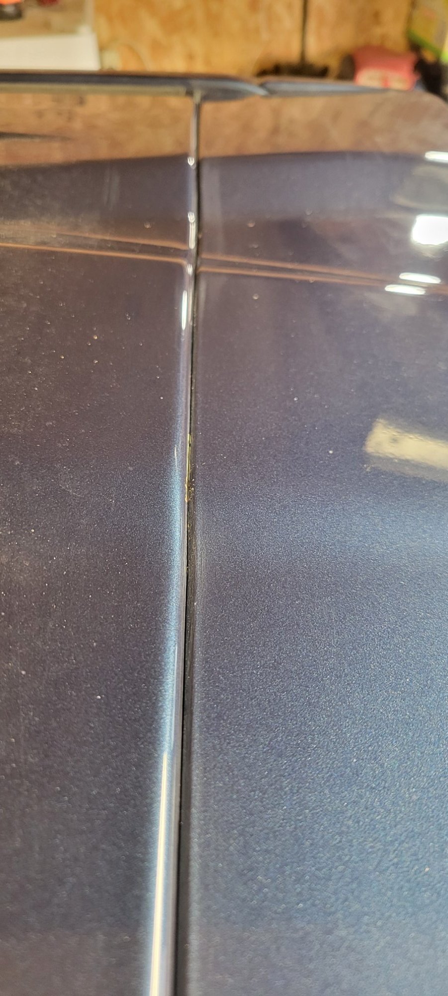

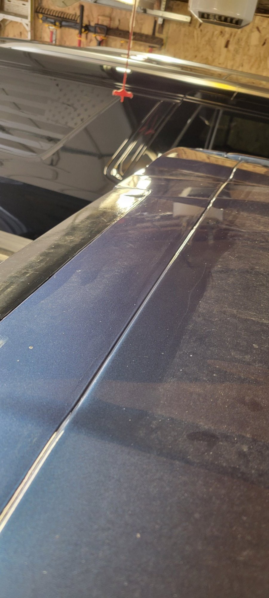

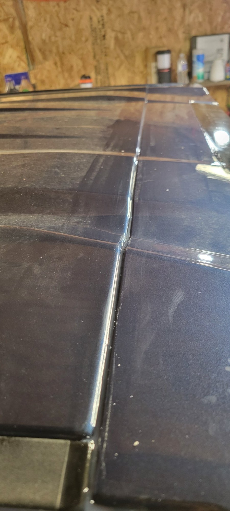

New member and have the same problem with my 2019 high country with the rear slider, truck has 71k miles and its the first time my head liner has been wet. I noticed water marks on my rear window a couple times and on my rear seat but never thought anything of it since I fish in the rain lot and figured it was from opening my door in the rain to grab things out of my truck. Yesterday we got about a half inch of rain and I noticed my headliner was soaked.
Read through most of the 235 pages and figured I'd give it a shot so bought most of what everyone was doing so I can fix it to.orrow since I'm drying everything out. One thing I noticed was my gap between my cab and spoiler isn't even, if fact there's a spot where it's so tight it chipped the paint off. Anyone else have this? Looking at the pictures it seems there's a pretty decent gap there for most people.
Mine was like that. One member on here had enough of a gap that he used some weather seal from Lowes. Mine was so tight it wouldn’t even get close to fitting.
I ended up going function over form and slathered some clear heavy duty sealant I had on that gap. You couldn’t see it unless you were standing in the bed anyway.
That and the windshield sealant around the window and my leaks were gone for the last several years I owned mine.
Edited by AJMBLAZER
Ya I saw that so I bought some but looks like I may be returning it unless I use it in the gap between the lower spoiler and rear window. I laid a nice bead between the cab and upper spoiler then wrapped it around the sides of the spoiler as a just in case. Can't see it unless you're looking for it. Ended up buying the permanent 81730 to fill it. The test will be Monday so guess I'll find out how well I did lol. We're in a level 4 for severe weather so there's a chance I may end up with a new truck anyway lol. Definitely love this truck and just got it where I want it so it would be a shame to have to get rid of it.
