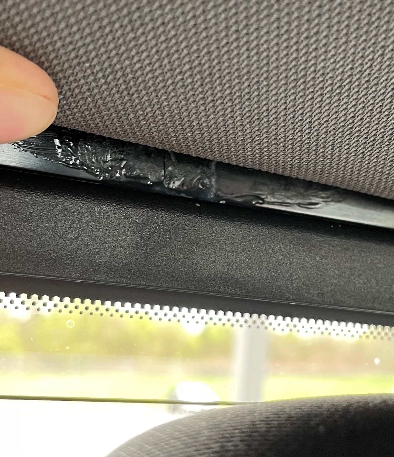

Well, I did do the fix.  I used the Barrier Bond gap sealant I linked previously since I couldn't readily find the other sealant.  I thought it was better than regular silicone.  I do wish it flowed a bit better but hopefully since I just had a very small leak after 4 years, that this will fix the issue for awhile.
A big SAFETY WARNING to anyone that attempts this:  When you are removing the headliner, make sure to use cut proof gloves when sliding your hands around the back of the cab to pull down on the brackets. The headliner is fiberglass under the cloth and I cut several fingers pretty bad.  Either take your time working your fingers in between the cab and headliner but best to where cut proof gloves.
Another tip I will give is to have a hot glue gun on hand just in case the rear headliner brackets gets torn from the headliner.  One of them was slightly separated on the corner and the other bracket was completely torn off.  A hot glue gun put it back quickly.
