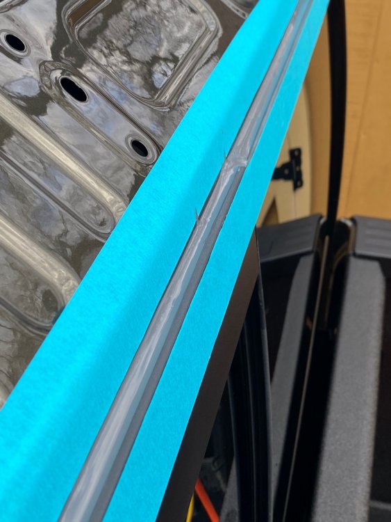

This is my 2nd Trail Boss with a leaking slider, both of them I bought new.  The first one I fixed myself by replacing the slider with a solid window (details are somewhere in the massive leak thread).  The second one I wanted to keep the slider and permanently seal before it ever leaked.  I've had the truck over a year and finally got around to it.  Since I was dropping the headliner I also added the camera rearview mirror and hard-wired my radar detector.

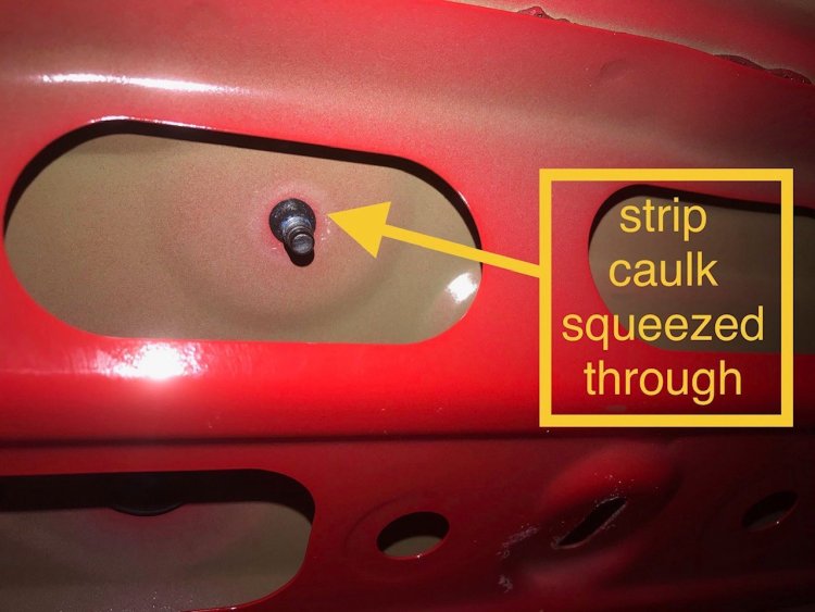

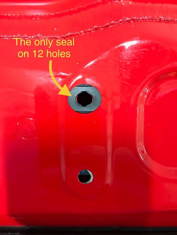

I dropped the headliner and removed the spoiler.  I cleaned the top of the window channel with all purpose cleaner and a detail brush and dried it.  I taped the top of the glass and back of the cab with some little tape ball dams at the ends.  I warmed the area up with a heat gun so it would flow then I applied self-leveling sealer SEM 39387 then I hit it with the gun a little more to draw out air bubbles.   After that cured, I put 3m strip caulk on all of the spoiler bolts and nuts and re-installed the spoiler.   The self-leveling sealer had the exact effect I wanted, it bridged from the glass to the body and covered up the plastic slider frame that cracks and leaks.  There were no cracks in the frame this time.  I also noticed they are putting a little sealer on the nuts that hold the spoiler on, but it's not adequate.  The way I did this it should never leak from the glass or the spoiler holes.
The mirror upgrade was easy, swap the brake light, add the cable and swap the mirror.  Plug-and-play.
I hope you got new nuts before you put it all back together.

18-NA-383: Water Found in Rear Interior of Cab, Water Leak at Rear Sliding Window - (Oct 23, 2020)
Important: The 8 central roof spoiler nuts are NOT reusable fasteners. The original fasteners must be discarded and replaced.
  1. Allow a short time for the sealer to develop a skim coat, then reinstall the spoiler and headliner. Refer to Roof Rear Spoiler Replacement, in SI.
  2. Allow at least 24 hours before running the truck through any car wash.
NO, unnecessary. The bulletin is BS.  The reason why they want that is because the updated nuts come with a "teflon-ish" type thin seal (see the white stuff in my photo).  The seal is completely ineffective.  First off it's on the inside of the cab and second they don't make an adequate seal.  Third they're $37 for new nuts lol.  If the engineers had their heads screwed on they would be recommending something like what I did.  I wrapped each spoiler bolt (8) in 3m strip caulk at the base and each of the spoiler nuts (4) on their flange.  When the spoiler is installed this sandwiches the strip caulk through the holes, creating a permanent seal 100x better than the factory.   Another fault with the design is that there are supposed to be thin seals on the spoiler side of the holes on the posts.  I found (1) total on my first truck and (2) on the second.  There should be 8, they simply don't get installed at the factory.  I take them off before installing the strip caulk.
