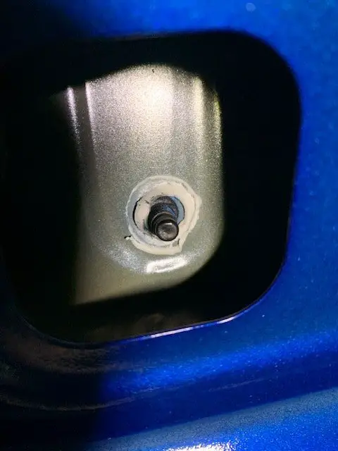

Couple notes on the spoiler reseal:
1. Those 2 lonely seals they include are only on the 2 yellow clips
2. the threaded holes for the 4 outboard bolts seem to have embossed rubber washers on the standoffs, which actually seem pretty good. I applied sealer anyway.
3. I removed all the body plugs, applied light sealer to them as well. Taking no chances!

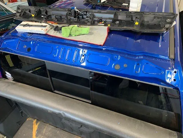

Just finished my ‘19 Silverado that had several minor leaks. Total of 5 cracks. 3 were fairly large.
I have done lots of caulking on several home projects and when I built engines.
 I laid in a goodly coat of premium clear silicone and top coated it with the w/s sealer. I can’t imagine how it could leak.
my only reservation (after putting it back together) is I didn’t put any sealer around the two plastic alignment pins nor the four bolts.
 I honestly didn’t think about those alignment pins….The bolts have a built in seal so less concerned about those.

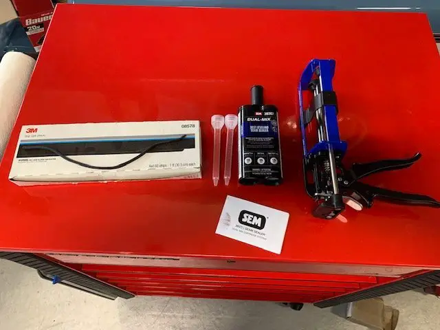

Quick question(s) .. Is 1 tube of the seam sealer stuff enough? And do you need the special gun for it?
Also would it be comparable to 3M 08307 seam sealer or would you think sems is better?
Edited by Chrisd534
3M is fine. One should be plenty.
I don't use that type when I do it, I use Kent Automotive High Tech Clear, but I see folks having success with the 2-part, so it should be fine, just clean, clean and clean it some more with solvent.

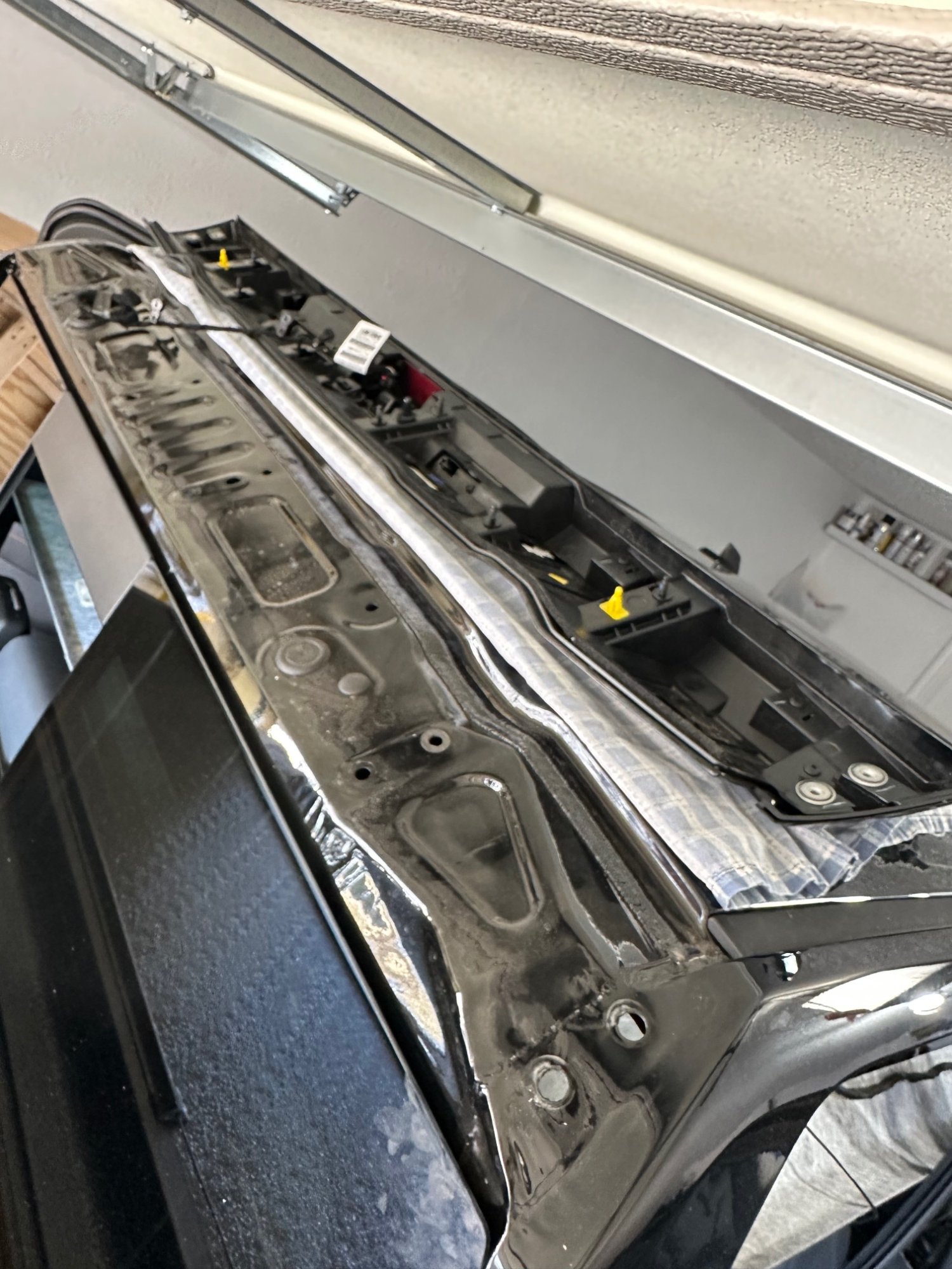

And seal every single thing that pokes through the roof on the spoiler.  The nuts have sealer on them, but most of it comes off and the GM TSB tells you to replace them because of that.  Definitely seal them.
Also be sure to tape off the plastic around the sliding window. If you get sealer on it and have to clean it off with solvent, it'll take the shine off of it.

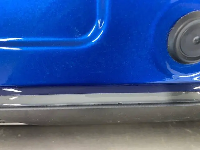

I dropped the headliner and removed the spoiler.  I cleaned the top of the window channel with all purpose cleaner and a detail brush and dried it.  I taped the top of the glass and back of the cab with some little tape ball dams at the ends.  I warmed the area up with a heat gun so it would flow then I applied self-leveling sealer SEM 39387 then I hit it with the gun a little more to draw out air bubbles.   After that cured, I put 3m strip caulk on all of the spoiler bolts and nuts and re-installed the spoiler.   The self-leveling sealer had the exact effect I wanted, it bridged from the glass to the body and covered up the plastic slider frame that cracks and leaks.  There were no cracks in the frame this time.  I also noticed they are putting a little sealer on the nuts that hold the spoiler on, but it's not adequate.  The way I did this it should never leak from the glass or the spoiler holes.
