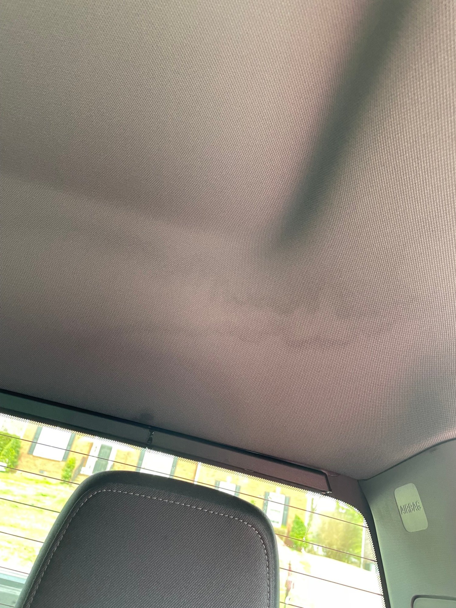

Codeman00 Posted March 2, 2023 Posted March 2, 2023 I am unfortunately here with the rest of you with the same problem on my 2019 Silverado RST. I will be implementing the TSB fix myself since I'm at 41,000 miles. Apparently the leak has been there for quite some time and I didn't know. I called my local dealer, Payne Chevrolet in Springfield, TN and asked them if they had either of the required sealers in stock. They said no. I asked what was I supposed to do if I can't get them easily and you don't have them. He said, you would have to order them, and then hung up on me. Amazing customer service when every truck has the problem, GM won't take responsibility and they won't even help you with parts.
outrag1 Posted March 2, 2023 Posted March 2, 2023 50 minutes ago, Codeman00 said: I am unfortunately here with the rest of you with the same problem on my 2019 Silverado RST. I will be implementing the TSB fix myself since I'm at 41,000 miles. Apparently the leak has been there for quite some time and I didn't know. I called my local dealer, Payne Chevrolet in Springfield, TN and asked them if they had either of the required sealers in stock. They said no. I asked what was I supposed to do if I can't get them easily and you don't have them. He said, you would have to order them, and then hung up on me. Amazing customer service when every truck has the problem, GM won't take responsibility and they won't even help you with parts. Do you have the rear slider?
Codeman00 Posted March 2, 2023 Posted March 2, 2023 (edited) 1 minute ago, outrag1 said: Do you have the rear slider? Yes. Why, did I miss something in the 230 pages that I need to know? Edited March 2, 2023 by Codeman00
outrag1 Posted March 2, 2023 Posted March 2, 2023 7 minutes ago, Codeman00 said: Yes. Why, did I miss something in the 230 pages that I need to know? No, I just couldn't tell from your truck description or the picture. There are questions on whether "some" leaks come from the spoiler holes in the roof, but it appears the bulk of the evidence here is from the rear slider frame itself. Best of luck with the fix. The write up on this forum is excellent.
Codeman00 Posted March 2, 2023 Posted March 2, 2023 1 minute ago, outrag1 said: No, I just couldn't tell from your truck description or the picture. There are questions on whether "some" leaks come from the spoiler holes in the roof, but it appears the bulk of the evidence here is from the rear slider frame itself. Best of luck with the fix. The write up on this forum is excellent. Much appreciated! I can actually see the cracks on the inside looking up at the window channel from inside the truck....so I'm positive I have the same cracks on top under the spoiler. I plan to tackle this project tomorrow, fill the channel with sealant...and I'll report back. 1
bfontenot9 Posted March 2, 2023 Posted March 2, 2023 1 hour ago, Codeman00 said: I am unfortunately here with the rest of you with the same problem on my 2019 Silverado RST. I will be implementing the TSB fix myself since I'm at 41,000 miles. Apparently the leak has been there for quite some time and I didn't know. I called my local dealer, Payne Chevrolet in Springfield, TN and asked them if they had either of the required sealers in stock. They said no. I asked what was I supposed to do if I can't get them easily and you don't have them. He said, you would have to order them, and then hung up on me. Amazing customer service when every truck has the problem, GM won't take responsibility and they won't even help you with parts. As one of many that have gone through multiple attempts and methods to “fix” the leak, your best bet is just to replace the slider glass with a solid glass. The first 3 “fixes” lasted anywhere from 2 to 6 months before it started leaking again. On my 4th attempt, I had a solid glass installed. It’s been almost a year and haven’t had any leaks. Saves a lot of headache too!
Codeman00 Posted March 3, 2023 Posted March 3, 2023 46 minutes ago, bfontenot9 said: As one of many that have gone through multiple attempts and methods to “fix” the leak, your best bet is just to replace the slider glass with a solid glass. The first 3 “fixes” lasted anywhere from 2 to 6 months before it started leaking again. On my 4th attempt, I had a solid glass installed. It’s been almost a year and haven’t had any leaks. Saves a lot of headache too! That is VERY disappointing to hear, but good to know going forward. I can see the crack and it corresponds to where the water is coming in...so hopefully....hopefully that will take care of it. Time will tell. Sorry you had to go back to a solid glass.
