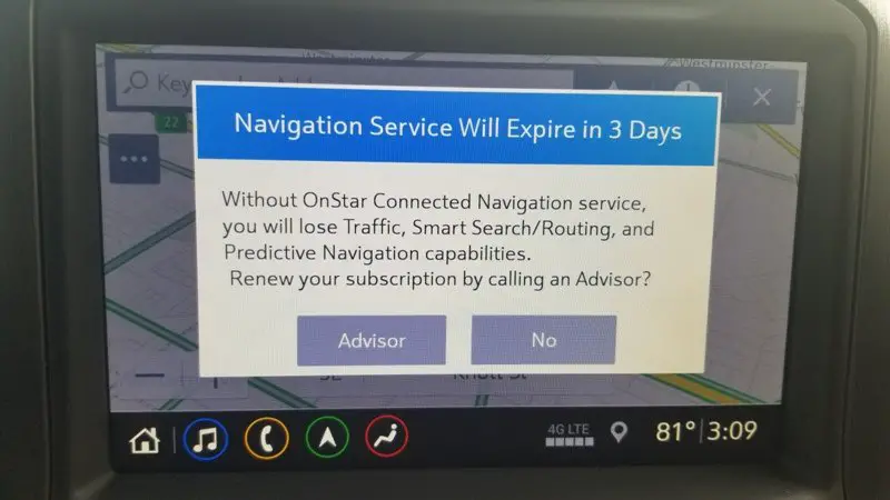

Hopefully someone has dealt with this on their 2019 already.
I received the attached notification on my Nav screen.
I pressed the advisor button and asked OnStar what was needed to maintain real-time traffic.
OnStar said it was only available from Sirius XM. To which I replied, “it wasn’t available when I signed up for XM radio” (I had it on my previous truck).
The advisor checked and said Navtraffic was only available from XM and transferred me to the XM rep. Who said that my radio isn’t set up for their Navtraffic and that I needed to go to the dealer and have it programmed for Navtraffic?
I replied, “Then how come I have traffic displayed on my screen right now?” the XM rep didn’t know and couldn’t help.
3 days later and traffic data no longer shows up on my Nav map.
Which to me means it’s handled through OnStar and is only available with their unlimited access plan for $40.00 a month. I currently have the Safety and Security plan.
I guess my question is – does any still have real-time traffic after their free month expired? and if so, which company are you getting it from?

Just got back from the dealer and they were absolutely no help.
Dealer says that I should be able to get Navtraffic through XM, and it's XM who does the upgrade not them.
So now, it's back to OnStar.
Does anyone with a 2019 have XM Navtraffic? or is the only choice for live traffic the $40.00 a month Onstar package?
I know I could just use Android auto, but most of the time I just need to hop in the truck jump on the freeway, and it would be nice to see the traffic conditions before i got on the onramp.
On Edit: I have both an Onstar account and a SiriusXM account for the truck.

Yes, been there done that. When I open my account there is no Navtraffic or Travel link option available like I had with my previous truck.
XM claims that my radio is not capable of using the plans.

Unfortunately, you are correct!
No $3.99 Navtraffic for the 2019 upper trim levels. For real-time traffic you need Connected Navigation, which is only available with the $39.99 GMC Unlimited Access plan.
Since it's a new Infotainment system, the OnStar reps seem to be unaware that Navtraffic is unavailable on the new systems. it took an hour on the phone with OnStar to get the unlimited access plan added back into to my system and another 16 hours before it was fully integrated.
