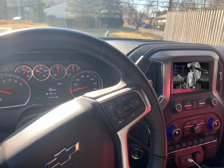

I’ve had every update. Parts replaced. Unit replaced. Still have issues as you can see. Picture taken today. I’m currently looking for a buyback/repurchase with a lawyer. Multiple other issues and believe it or not gm won’t even respond to my lawyer after over 3 1/2 months of waiting. Going to court now. The truck is well within the lemon law for my front differential issues alone. I can’t wait for a new one. Hopefully
I had read years ago that all this technology had been reverse engineered from alien spaceships that crashed at Area 51. Might be alien revenge......After looking a bit closer I think that I see ET is actually on your infotainment screen!!!!
It's better to laugh than cry
