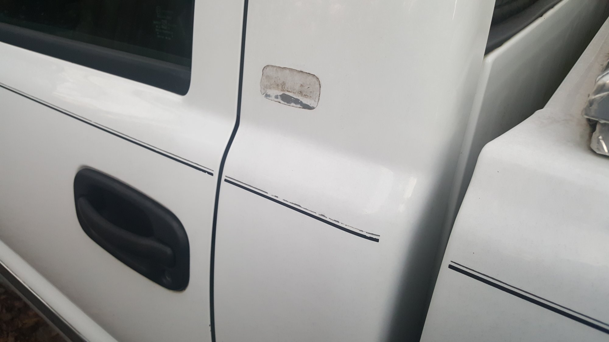

Anywho - txab - What does your cab badge / emblem say?  SLT?  My dad's came off in a car wash (both sides).  I'll replace them if I can find them at a reasonable cost.

7mile..... SLE and SLT are the decals. Probably best to remove the rest of it as well as the other side.
