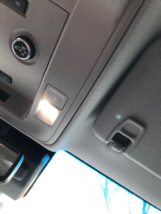

I've had a water leak appear near the passenger side of the controls for the sunroof and such a few times now. I checked with the dealer and the solution was to open the sunroof and spray compressed air into the sunroof drains. This has happened a couple of times now. After heavy rain and wind yesterday I have a leak in a new place, on the a-pillar. If memory serves me the dealer told me this could be related to the antenna that sits on the roof on the drivers side. Does anybody know how to solve this?
The shark fin antenna has developed a leak.. Take it to the dealer and get it fixed..
You're going to need a new antenna.. The new one will need a bead of clear silicone around the outside of the foam seal before you install it.

If you are under warranty just let a dealer replace the shark fin.  If you are out of warranty or want to tackle it yourself here's a video on a Silverado (should be similar) as how to access the antenna.

Most likely the Onstar antenna, other possibility is the actual gasket on the sunroof. My 14 leaked in a few spots, and they did change the gasket along with the antenna. There were two types back then, a one piece without a "cut" in that they had to put on like a sock, and the new and improved on with a cut in it that did not leak.
