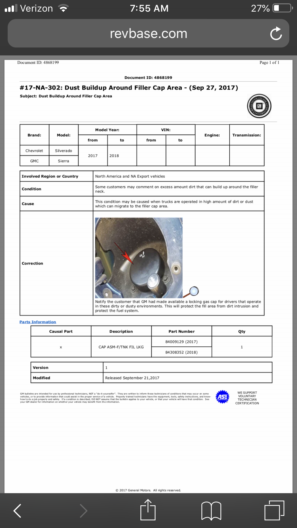

18 hours ago, newdude said:
I've posted these elsewhere before on this forum, but GM makes locking caps for the K2 truck capless filler neck.
84009129 (2017)
84308352 (2018–2019 K2)
There is a TSB referencing these part numbers...#17-NA-302
