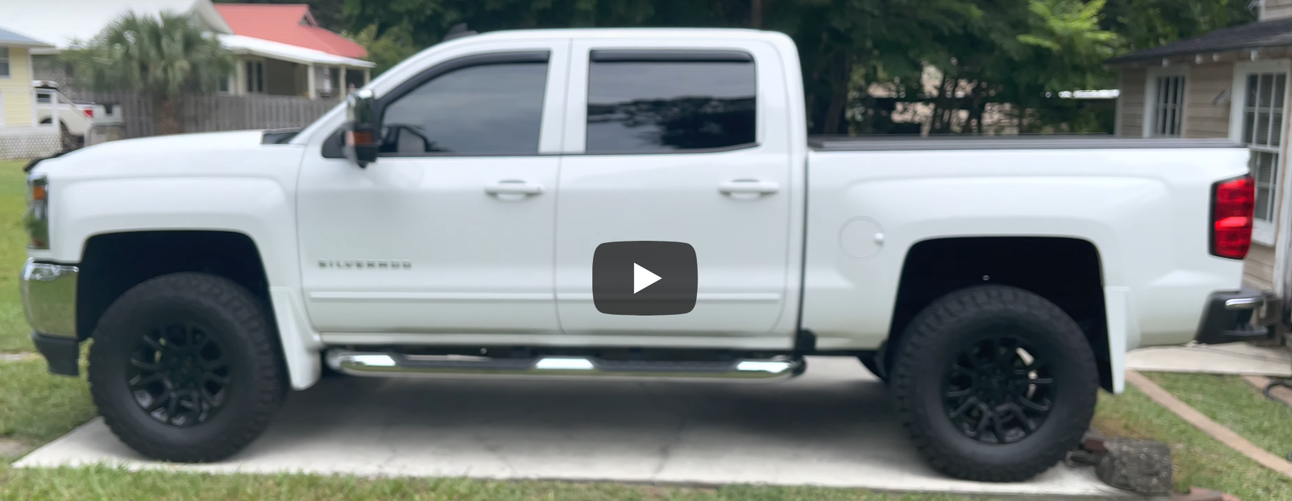

Link to the screen capture:
Edited by MikeBMW
27 minutes ago, MikeBMW said:
I'm running 35x12.5 BFG ATs on a 3" level (with Motofab controll arms) and a 1.5" body lift along with a 1" Bilstien shock lift.
That's 5.5" (rears are a 1" block lift and a 1.5" spring lift, as well as the 1" Bilstein shock lift.)
My 35s are close but the Bilsteins help control the articulation.
My wheels are stock +24. With -38 wheels on a 2" level, you'll be hitting the rear of the fender, maybe not the front since you've already modified the front of the front fender, I guess, with the prerunner bumper?
If you haven't, you will rub.
Yes they do - 2019 and beyond, excluding the LDs.
