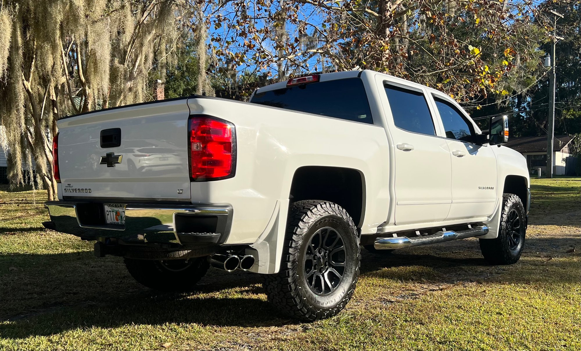

so got the 2 inch front spacers
3 inch rear blocks
1.5 body lift
-38 mm offset wheels
33.5x11 rub on full lock.
mechanic says when in doubt pound it out. He did this on his 2500.

FINALLY!!!!
ever so slight of a rub on full lock. Rubs the middle of the backside of the front fender. Could do the nocal mod. Last option. I’ve done everything else. Don’t wanna go bigger. So. Where’s the sludge hammer? Lol.
it may not rub if I take off that plastic piece there but, id like it folded up honestly. Do it once now save later.
LOLZ I posted twice. Ops. It rides better than factory I swear. I hate 20s.

Let's see a side view Al.

Looks good! You might want to look at some flares though, the sides of truck will get blasted :fart:
Someone down the street from me has a Ram with a high negative offset. And when road conditions are bad, his truck looks like it's driven through a hurricane.
Maybe depending on how they’re mounted. My wrangler was the same way it got blasted. Lol. Trucks worth a little more tho. Maybe I should look.
