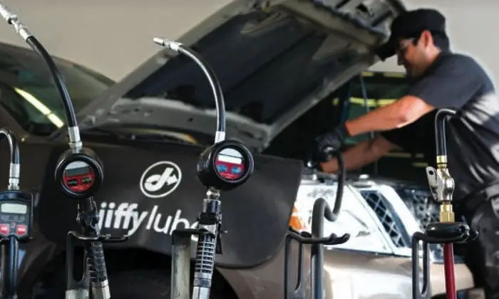

Define bulk. Where I worked the lubers had 500 gallon drums and a tap on the wall but the volume readout quit a long time ago. They just filled their jug to a mark and poured it in. Then there were 55 gallon drums with a hand crank to fill the jug for mobil 1. Both bulk but not very precise. And did I mention, never pulled a dipstik. When I bitched to the service manager he said he was happy just to get help that would remember to put the oil cap back on.
Wow, that's sad. I don't know the "bulk" containers but they are somehow pressurized or pumped out. There at good ones and of course I don't know or can't speak for what everyone uses...just going off what brother told me. I am guessing they are something like this and he says theirs are checked regularly...probably to save money from any overfill more than anything!
