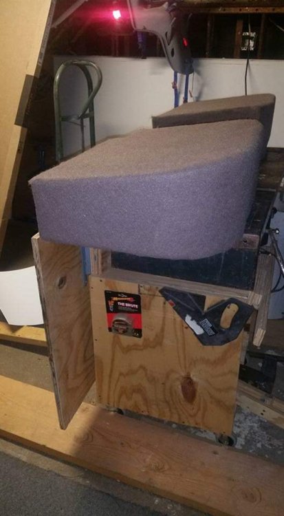

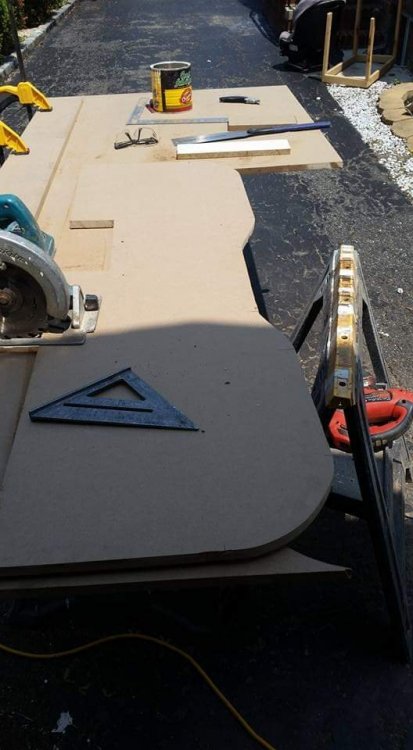

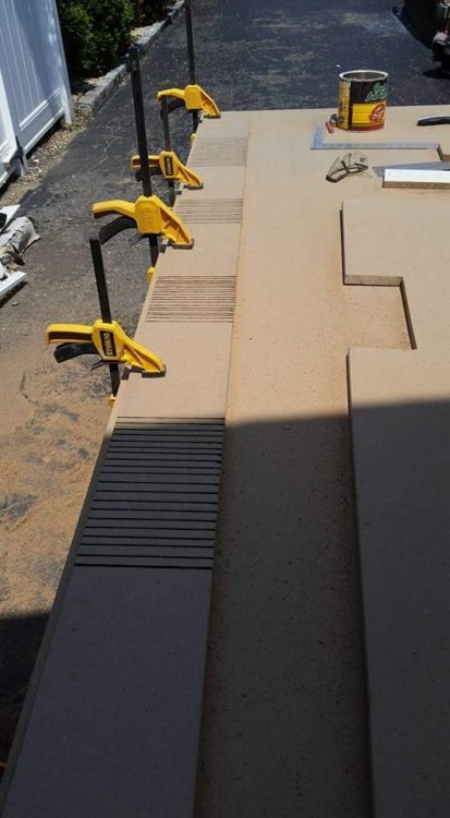

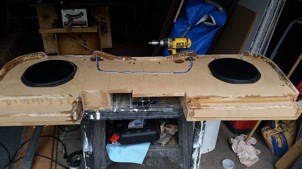

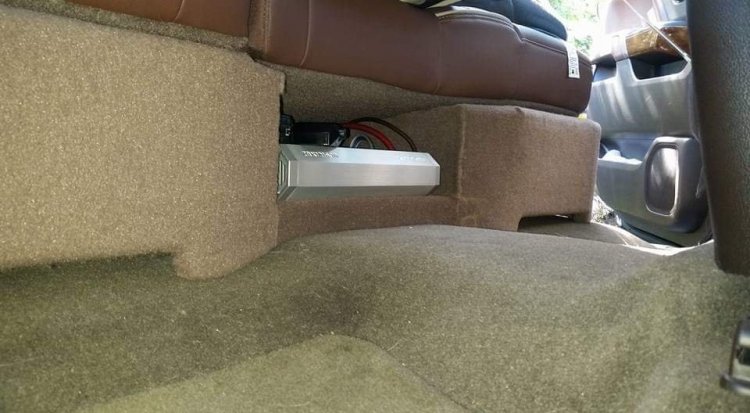

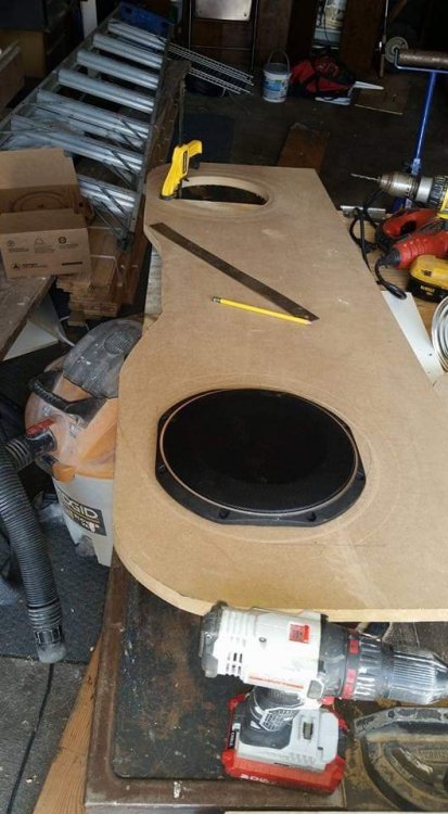

Not much space. A seat lift can buy you a little. More but again very limited. I build all my own. It is easy labor but requires skill and how to also a lot of tools.
Drill, drill bit, wood screws, liquid nails, air nailer, saws jig or router, sanding tools, ect...
MDF 1/2 or 3/4 is standard. But also duraglass, fiber glass, skim coat.
In my last truck I did wood box with fiberglass top on one side and a cargo box on the other side. Cargo bin was MDF and dropped into the enclosure it was done in bed liner.
This truck is carpet box. I made a cast of the floor boards then wood on the sides and top. The glassed bottom gave me more space and depth. But also is a perfect match to the floor curves so it doesn't move. 7914d2db86a19cf3d27ecf2c4a6bf181.jpg75f69aef670bba9ad09098b133038218.jpge54d719a6413a695412b11398b5bf51a.jpgff72dc247cb803ac235661c6f964ace0.jpg
