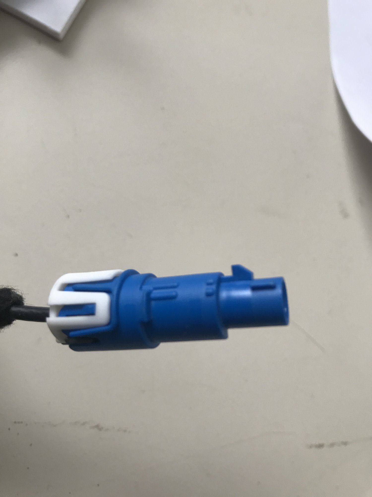

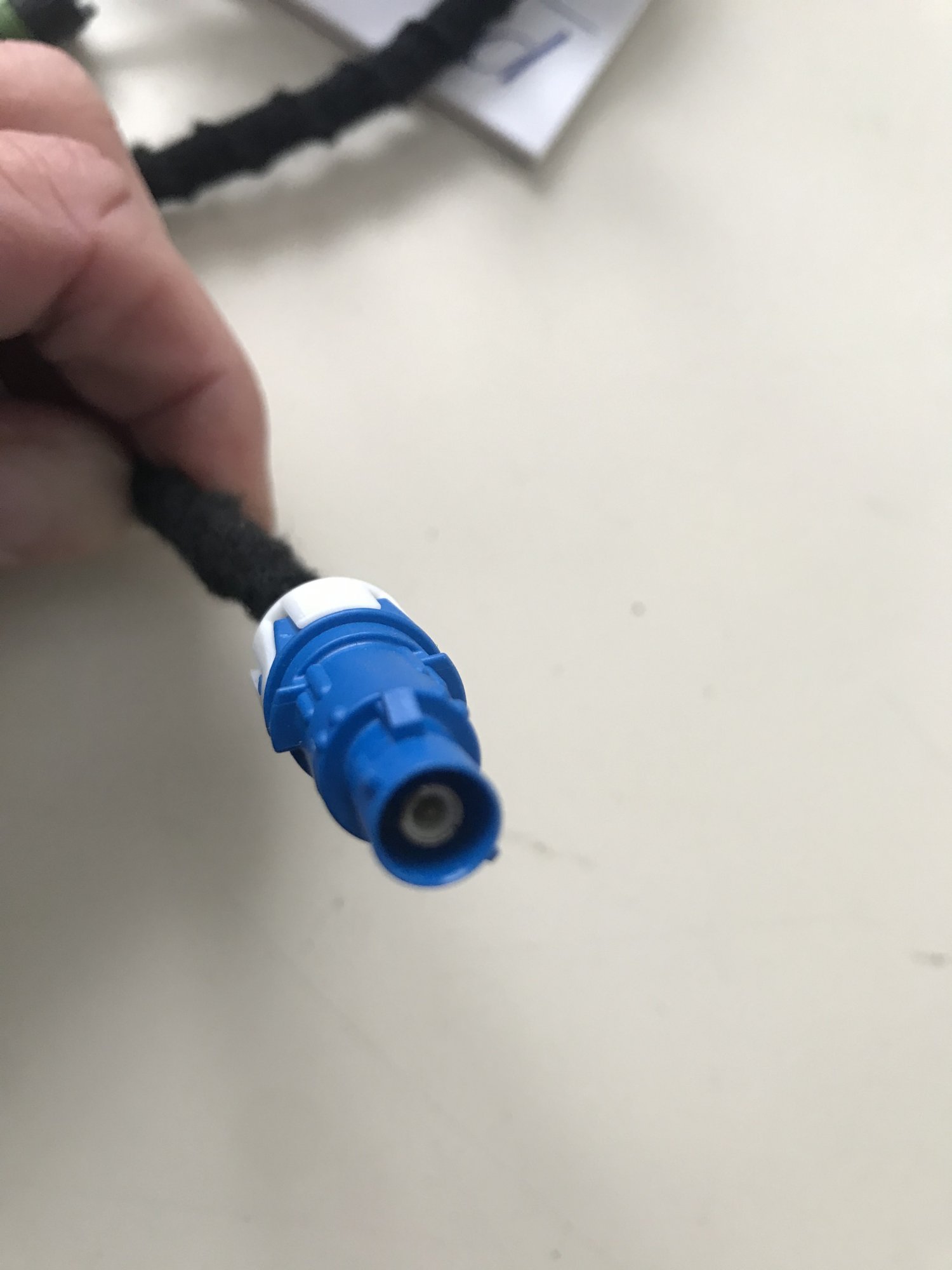

Can anyone verify if this is the same connector from the trailer camera that plugs into the back of the truck?  Thanks!

My camera wires were connected to that blue plug before they were connected behind the bumper.  I had only one connected and connected the other myself, now I just need a camera. There are two of those blue plugs connected to nothing behind my bumper.  what is your plug connected to?

This is the harness that is in the headliner that runs from the rear view mirror to the camera in the third brake light. I bought this harness to see what connectors it had on it. I have installed a cap on the truck, so now that camera is blocked. I was going to try to make an ‘extension cord’ to extend that camera and install it on the back of the cap. If the camera that mounts on the back of the trailer has the same plug, I could buy that which has 30 feet of wire, mount that on the back of the cap, plug it into the harness in the headliner, and have that camera on all the time in the rear view mirror, like it is now. I just don’t want to spend $400 dollars or whatever on a guess that the connector is correct.

The rear camera wires plug into that blue plug on the open end pictured.  The opposite end with the white cap was blank with no wire.  just used to hold the wires up out of the way.
