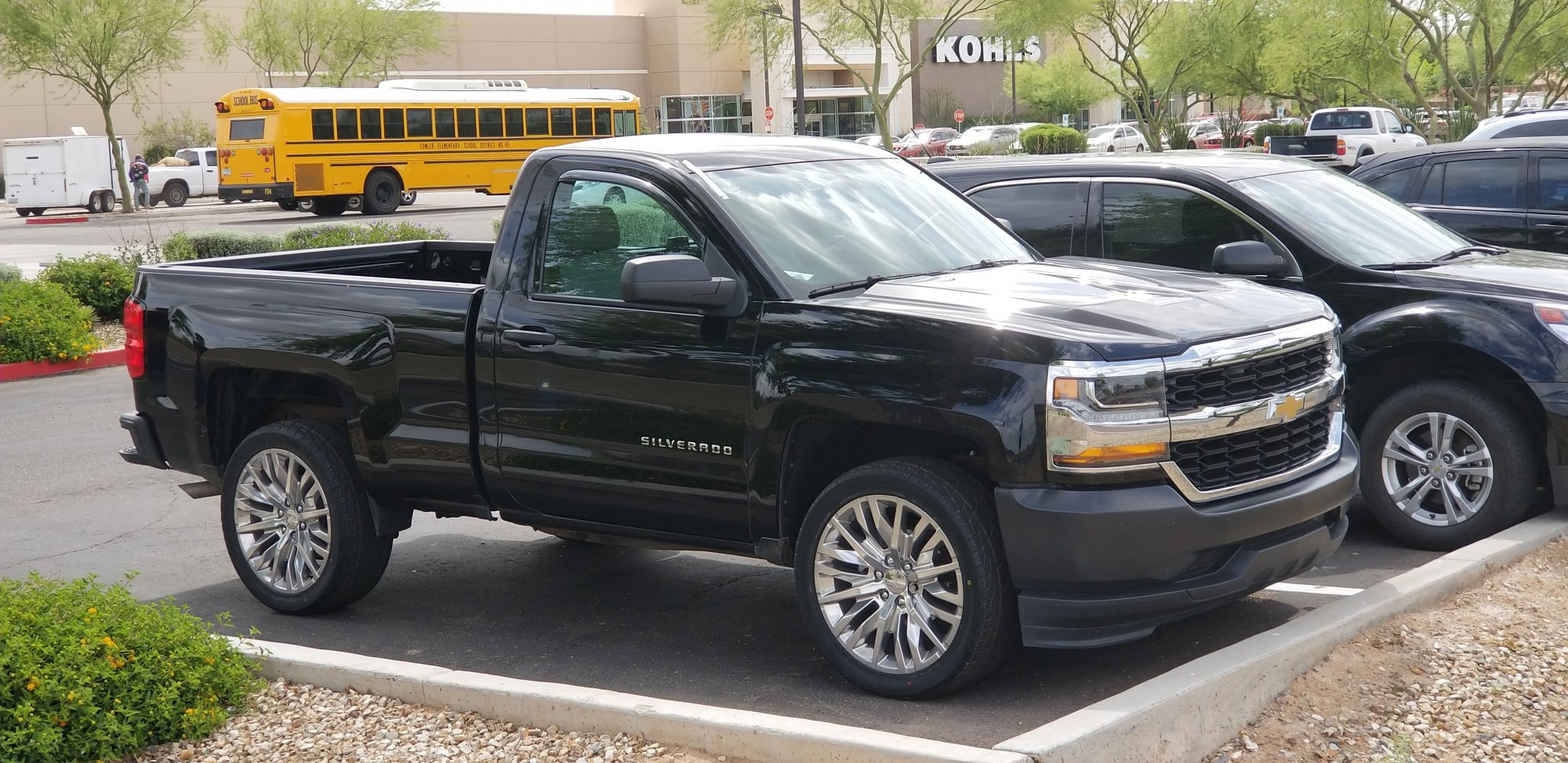

Hey there, i Own a 2017 Silverado 1500 WT Singlecab. Currently am trying to figure out how one would add remote start. My Truck came without keyless entry but does have power locks. The windows however are manual. Would I have to add the keyless entry kit first to be able to add on the remote start kit? Also would it be best to buy and install at dealer or maybe buy part online and take to dealers and have installed?
