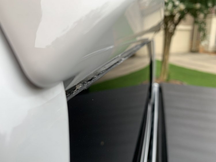

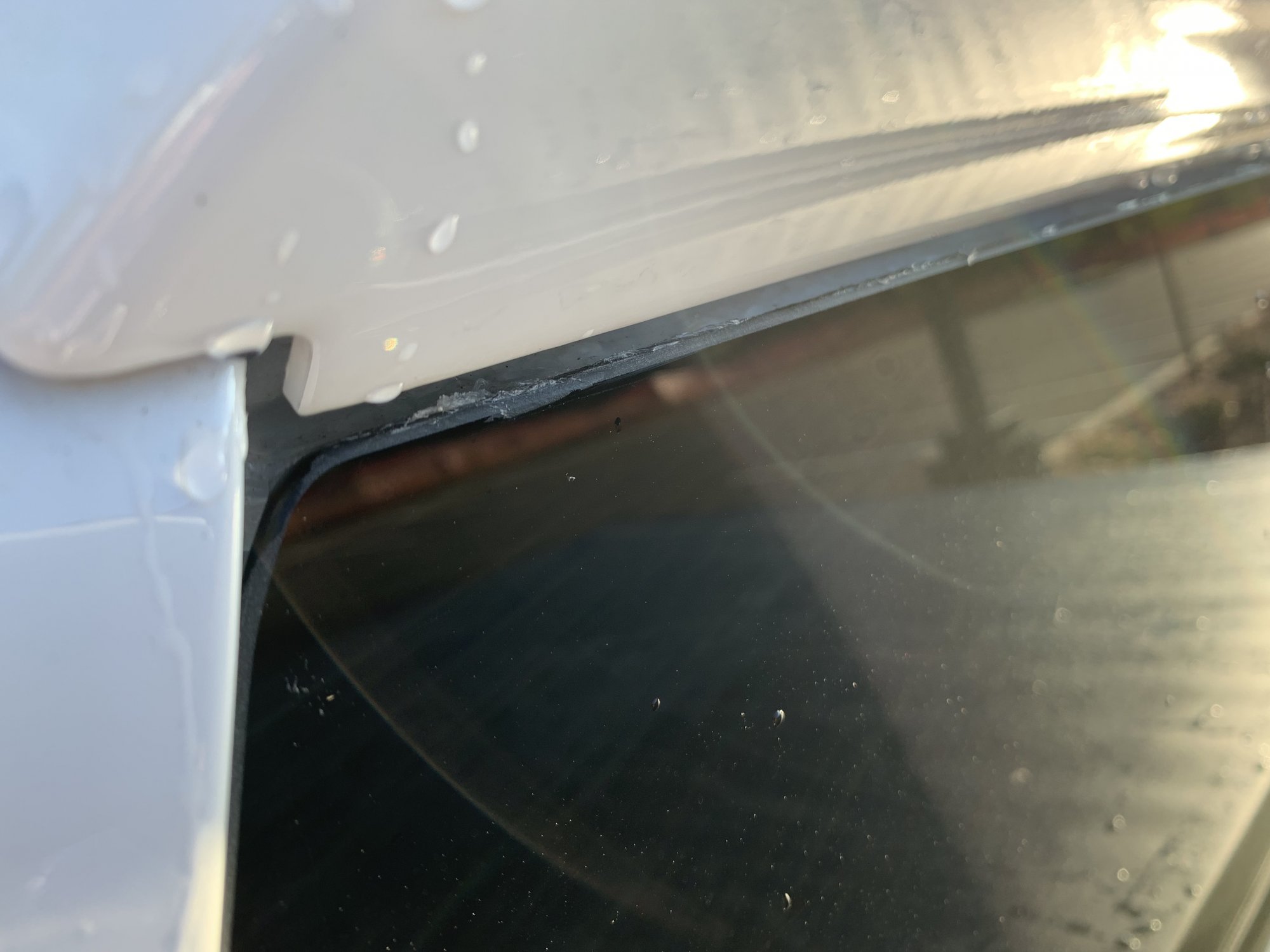

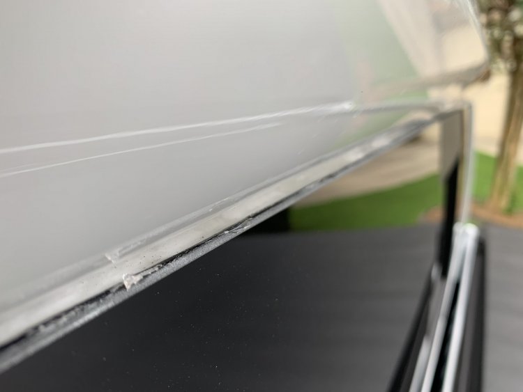

New 2019 Silverado and having the same issue. Have been to dealer twice and the below pics show their “fix” the second time.  That just filled it with caulk until they couldn’t any more. Really pissed that is how they “fix” a $50k truck. Thinking about demanding a replacement window all together. Thoughts or recommendations?  Sometimes I feel like continuing to push just causes more issues.

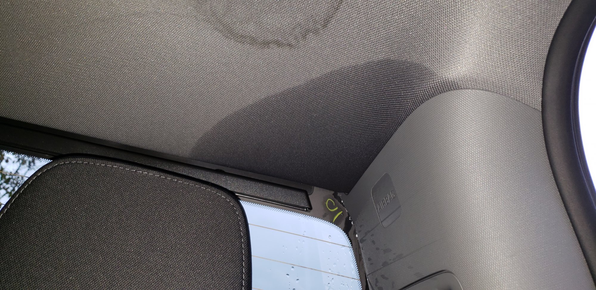

i just noticed a water leak on my new truck, i just got to the dealer service department to make a service appointment. While talking to the service advisor i ask him about whats going to happen with the headliner that has obvious damage due to water, he said they going to clean it and that they will not replace it with a new one. I wonder how soak my seats got before i noticed the issue.
there's any one that had this issue before that can give me guidance during this process that I already hate?
thanks everyone!!!!

On 12/3/2019 at 8:39 PM, Tony Weaver said:
Picked up my 2019 Silverado LT in mid October. I live in South Alabama and we had no rain for several weeks but the first rain, it leaked. Run down rear window on drivers side onto the seat. Less than 600 miles on vehicle. I took immediately to my dealer and showed them many photos I took to document. They were able to duplicate leak and informed me about a TSB related this known issue. They sealed the leak and then the opposite side began to leak when they rechecked. I demanded a new headliner due to water stains and cleaning chemical residue, so they ordered one over 3 weeks ago. No idea when it will arrive as of today. Soon to be a month in the shop. Any idea how to put a new headliner in a truck? Remove the windshield! Oh boy. Thank god I'm a patient guy and have a good service advisor. My biggest gripe is it was a "known" issue for a long time. I worry if my $50,000 truck will be the same. Only time will tell. Good luck to those with similar problems.
Had the rear window TSB done but the Dealer buggered reinstalling the 3rd Brake Light Assembly so it leaked worse than before at either the bolts or alignment pins.  Sealed from the inside this time (I know - not ideal) and I had the Dealer spray the truck down heavily with me inside (headliner down) to verify no leaks.  Having trouble getting them to properly dry the carpet padding rear AND driver side front while we wait for a new windshield (broke the old one during removal).  Headliner is being replaced but not until I verify dry carpet padding.  Service Dept. is terrible.  Really frustrating.  Way to go General.

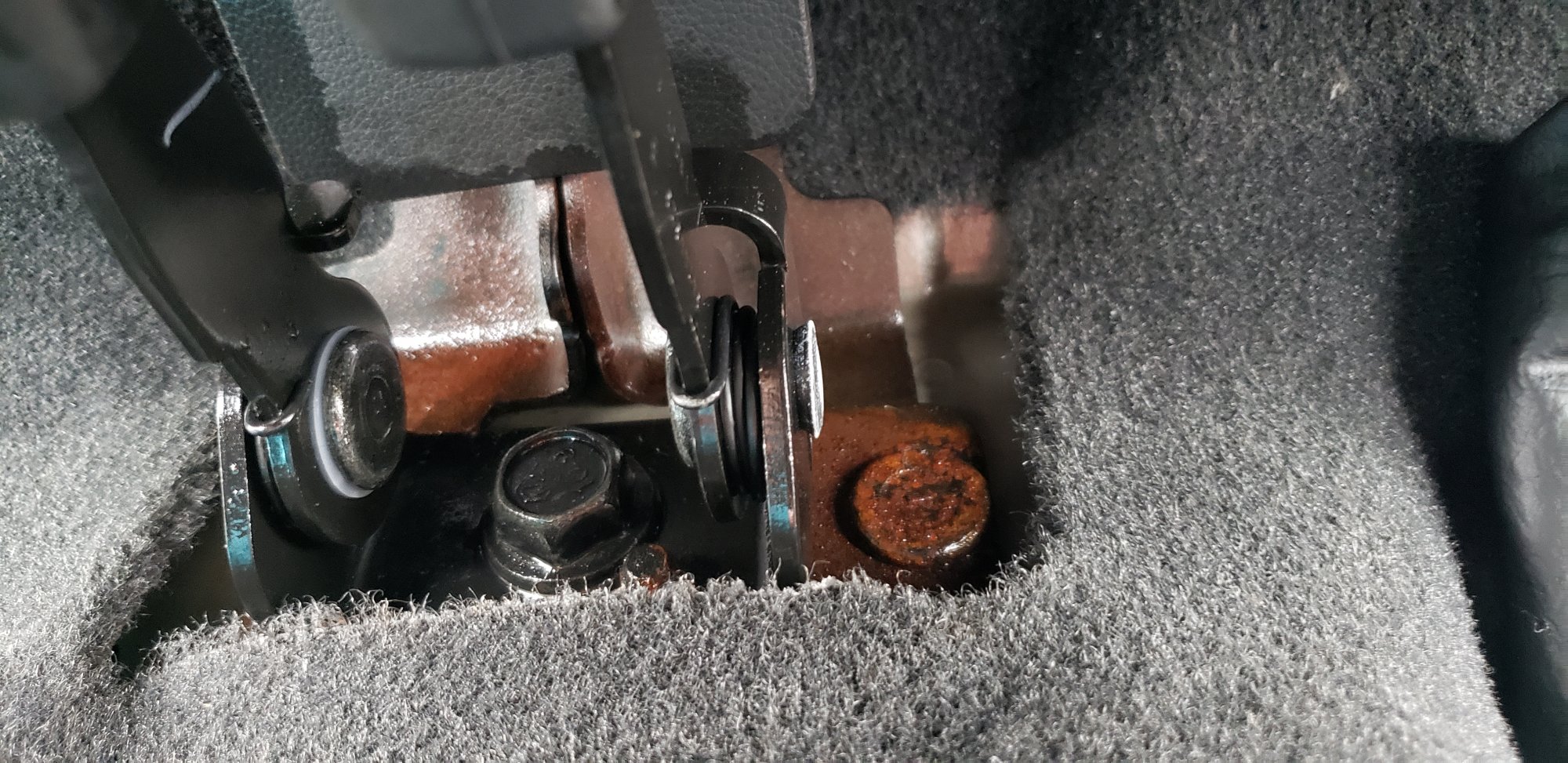

Just a side note to those with water leaking into their vehicle. Be sure to check all seat brackets and any metal part under the seat. I had rust on bracket bolts and even on the jack which has never been taken out of its holder.
