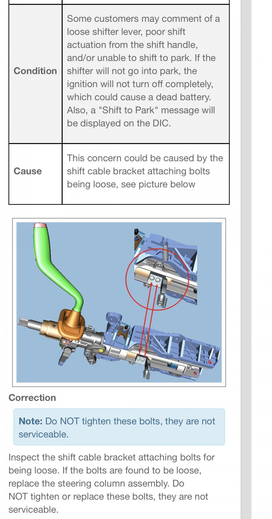

16 minutes ago, 17Allterrainx said:
Its annoying as hell. Mine does the same thing. Very poor design.
Take it in. I brought mine in for that today along with various other issues. Figure while they are gutting the interior for the leaking window they can do the steering column too.
I was getting used to living with it, but I saw the TSB, and well, everything else was pissing me off with the truck today so they can deal with it now. Hope it costs GM a lot of money to fix. Column shifters have been around for what, 100 years? Should have been right from the start. /end venting.
D2097A41-60EC-4CA7-BE79-1269F484817F.thumb.jpeg.99384d4cd3e3a6cbe9cec764c95c4555.jpegBE76682E-D286-40F6-9EC3-59B580A8D1FD.thumb.jpeg.f929968469571a3fa3a76a8c7d27da13.jpeg
My early build wobbles. The loaner I had built in March in Mexico was tight as hell almost no movement at all.
Let us know how the issue gets resolved with the bulletin
Sent from my Pixel 2 using Tapatalk
I don't understand why they are not serviceable. I actually took mine apart and got to those bolt but they were tight.
Dunno. Even if they were torque to yield, which I doubt, it shouldn’t matter anyway if they weren’t never tight in the first place! At any rate, there must be some other issue if yours were tight and you still have the wobble.
I just have a lot of difficulty accepting it. It may be “normal” but it sure ain’t right. When even my wife asked me if it should be loose like that going down the road, it obviously looks like something is wrong, to even an outsider.
I should hear back tomorrow with an update. If they decline a repair because the bolts are tight, one might have to go in there, loosen them a turn or two and take the thing to another dealer...?
