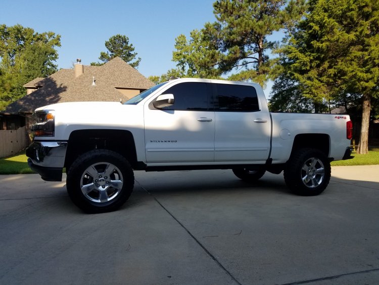

Yep.
Here's mine on 35's and stock snowflakes.

In my opinion your truck is the perfect combo or balance of wheel/tire/lift. Pure awesomeness! Well done.

Love this look, what is you suspension setup? Any spacers or rubbing?

Thanks sir.
No rubbing or scraping anywhere in forward or reverse.
Setup:
Zone 4.5" lift with Bilstein 5100's set to lowest setting with Bilstein 5125's out back.
Bora 1.5" spacers out back.
Tires: 35x11.50x20 Nitto Ridge Grappler
