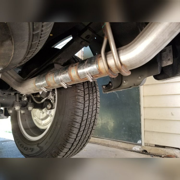

Finally got some time to do this to my RST today. LOVE the difference it makes. It’s the perfect noise level for me. The depth of the noise and the growl are definitely noticeable. I can even feel the growl on the gas pedal when I floor it. ????
I opted to just use sheet metal to cover the screens, as I wanted the option to remove them cleanly if I ever wanted to.

First of all thanks for these posts.  This will hold me over for now without spending much money.  Is the rectangular bracket Needed?  How does this work? Sorry I'm not very mechanical lol.  If it's needed I want to make sure I get the right part.  Any tips are much appreciated!
For the flapper valve yes you need a rectangular piece of metal between the two clamps to hold the flapper open.

Ok sweet.  I got it done today!  I'm not really mechanical but your pics and description made it pretty easy.  Some of the clamps I used were too big but good enough.

I don't think you got the flapper valve clamp on there correct. The outer clamp should be on the knob not the inner spring. Also make sure you rotated the flapper knob the correct way. It should get harder as the spring compresses that is how you know it is rotated in the right direction.
Sent from my Pixel 2 using Tapatalk
At least that is the way I did it. With your clamp in the middle it might mess up the spring or come loose?
1 hour ago, ShamrockShooter said:
Ok, thanks for the heads up.  I'll move it over.  And yeah in one direction it had resistance and the other it didn't.  I rotated so it had resistance.  I think I'm going to go with a black widow mufflers and have the flapper removed.
