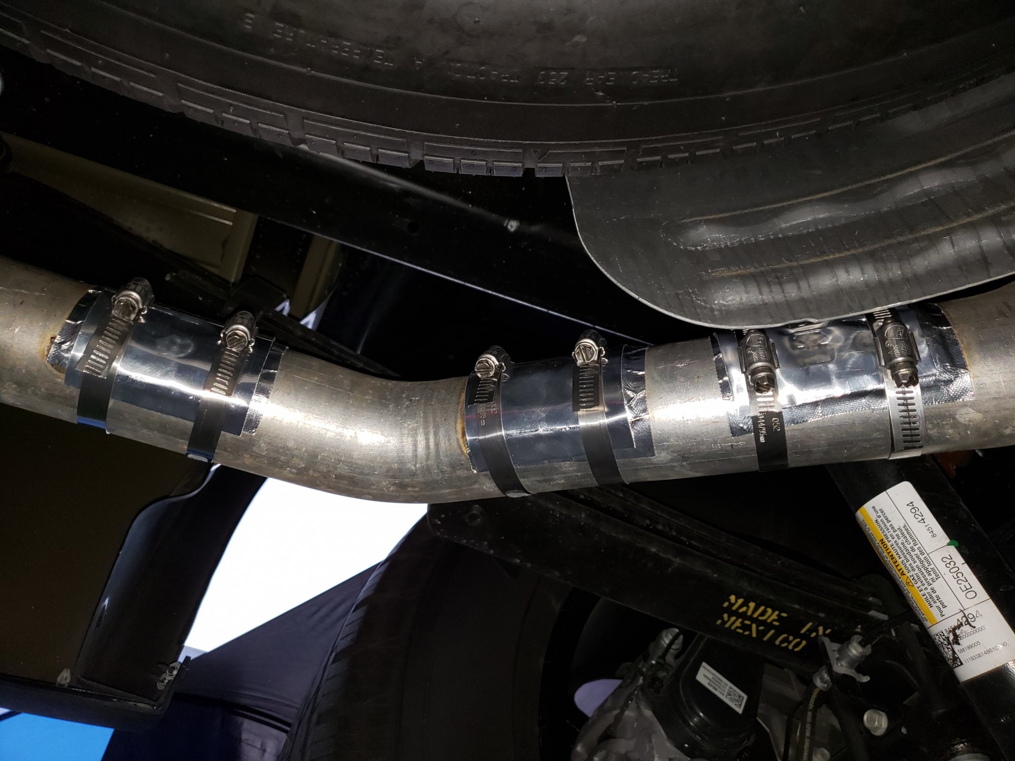

Just completed this. Simple process using a piece of sheet metal and clamps as others have posted. I too turned the flapper towards the front of the truck. Thanks to all of those who posted and added pictures!
After almost 2 weeks of driving with this mod, the only time I hear a concerning noise is when the truck auto-stops at a stop light, then re-starts. It sounds a little choked whenever that happens.
Otherwise, loving the mod still. :thumbs:

Did mine a couple days ago.  I had some left over HVAC aluminum foil tape and taped up the "vents".
Then for the flapper mod, I took about 4 1/2" piece of flexible metal strap and made a "U", with equal length's on all 3 sides, tightened it onto the outside of the flapper valve, turned it the direction in the pic, then tightened the inside with the hose clamps.
I've driven it a few hundred miles and the tape is holding up fine, and with it being taped facing the inside of the truck, you can't see it from the wheel well.
Again, it's not going to make your truck set off car alarms...but does give you a nice little sound improvement for in my case, just left over items in my barn.
**UPDATE Noticed tonight (9/24/19) that most of my foil tape patches have blown off.  Guessing too much heat for the adhesive on the foil tape.

The weather played nice long enough for me to get this knocked out, this past Tuesday night.
Really a nice change in tone, not to mention the almost 2 mpg increase I've noticed.
This mod definitely ranks high on the Bang for the Buck list.
I used DEI aluminized tape and thin SS muffler repair pieces cut into 3x3 sections as well as 2 clamps per piece.
On the valve, I did exactly like Cohocarl suggested with a 4.5" long piece of flexible hanger strap and two clamps.
Take care around the drivers side tail pipe screen where it's close to the heat shield. The shield has a very sharp edge.
