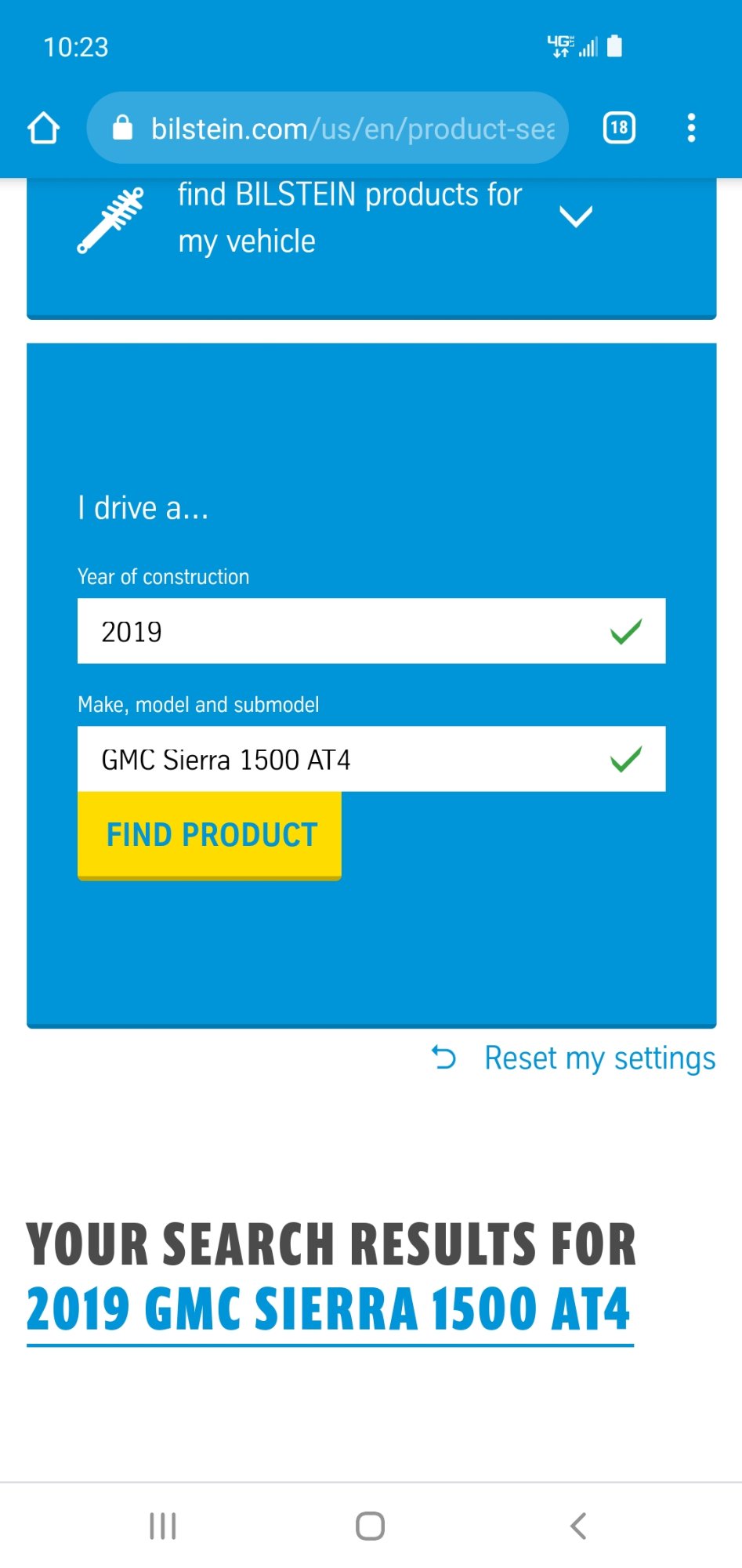

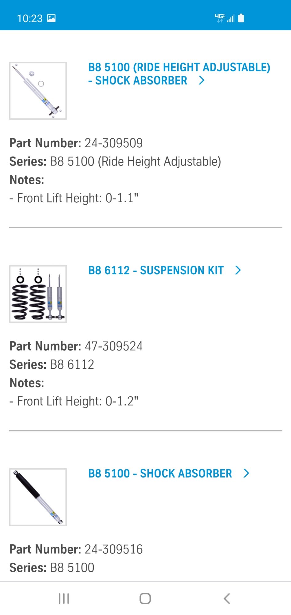

Which part number bilstein shocks for the back and the front? I don't know wich ones to get cause on the 5100's one says for trail boss only and the other 5100's say for 4x4 gmc but they have the same 0" to 1"
Edited by ODINAF
What year an model truck do you have? I have a 2021 gmc 1500 AT4....I can tell you those parts numbers if you have the same truck? If not you can go bilsteins website and punch in your truck info.....i also called there tech support to confirm the model numbers for front and back. On the front I went with there complete coil/strut kit because they were a better strut and there coil is a little softer thn stock. It rides so nice now.
It's a 2019 gmc sierra at4 but i don't think there's much difference from the suspension then your 2021, I can't wait to change mine out the ride quality sucks
Edited by ODINAF
11 hours ago, Liquid Plumber AT4 said:
I went with the front strut/coil kit part number 47-309524. And the 24-309516 for rears. Set the circlip on front struts to #3 setting and it leveled the front end almost perfect. Highly recommend them.
Looks good thank you appreciate the help
