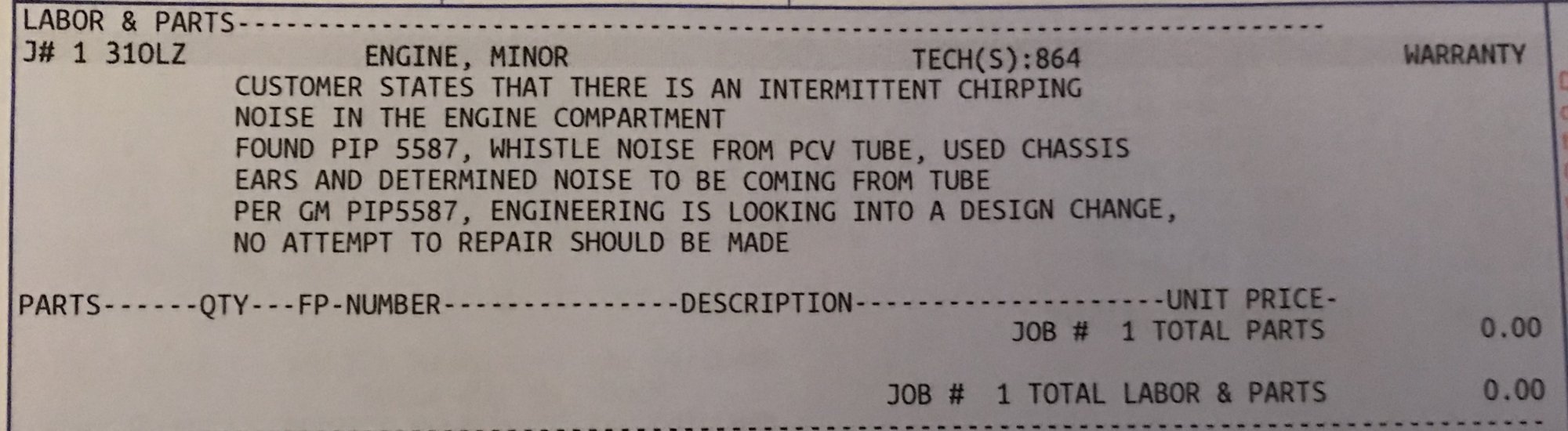

Picked mine up today, they couldn’t fix the noise....they could repeat the noise but couldn’t repair.  Here are the notes.  They started aTAC case and I asked how to check in on any progress, they told me it was internal with GM and they would update me when there is information. Upside....they aligned my bed and it looks better.....down side they scratched my door and it has to go back to the body shop

Sorry to hear that. My dealership told me it’s the pressure control valve & found it using chassis ears. Might be worth it to have them try that if they haven’t already when you take it back in.
I’d urge you to have your dealership to try using some chassis ears on the PCV pipe & see if that’s from where the noise is coming. See my other posts in this thread. Nothing in your report shows they used those find the source of the noise. Not implying everyone is having the same issue but would be nice for them to check it out. If they can’t, take it to a dealer that can.
