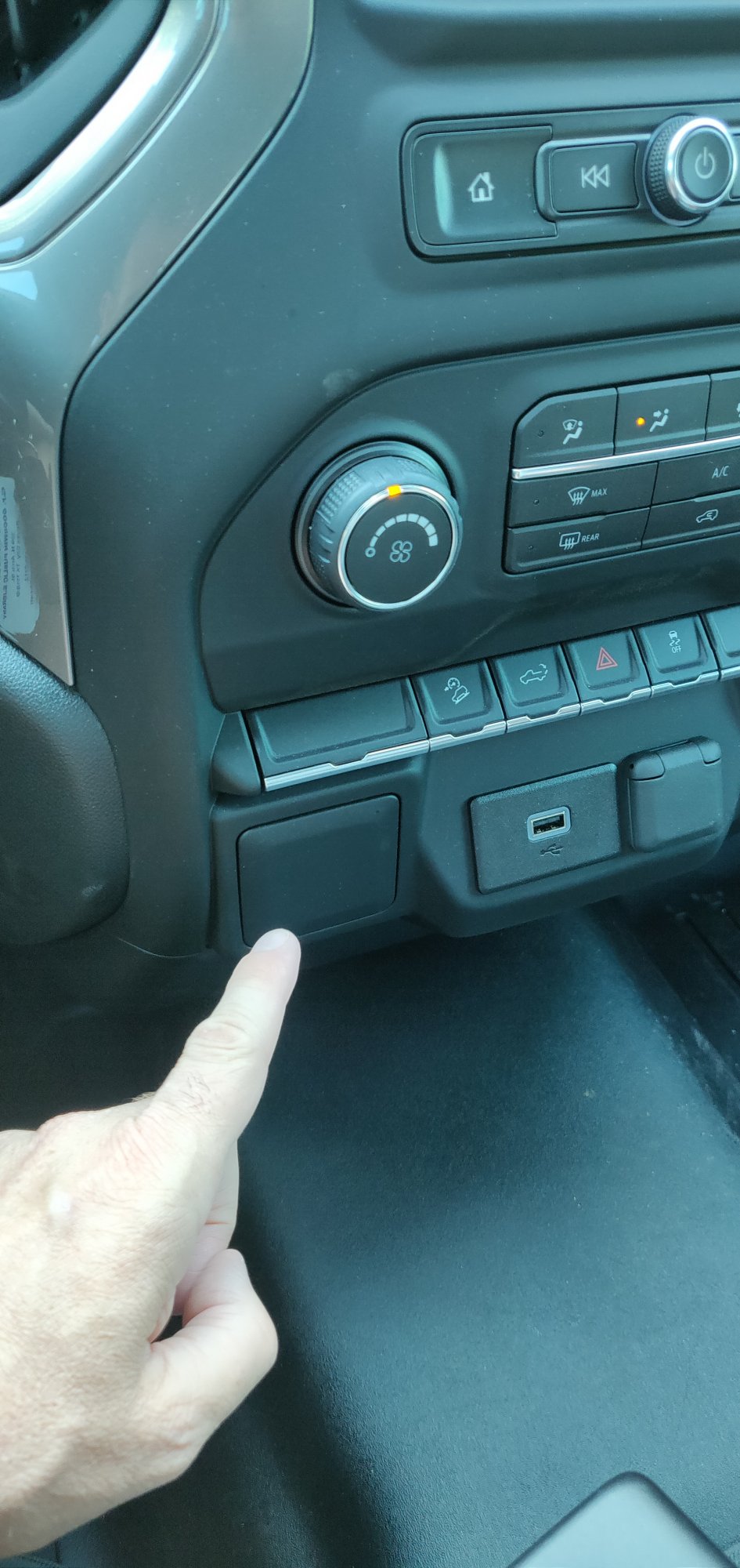

The wife and I are thinking of taking the kiddos on a camping trip and towing along a camping trailer.
The only problem is, I've never towed anything other than a small trailer for my bike. (No supporting brakes)
My question is: Will I be able to tow a camping trailer that has additional braking, even tho my CBT does not have the "brake tester" feature on the console?
Will the additional brakes on the trailer still work or will I be solely relying on the trucks brakes?

Do you think I can get the factory brake controller installed at the Chevy house?
Go to the trailer place and talk to them.  They'll know if the trailer has brakes, and what you'll need for your vehicle to be able to tow it.  If it's at all a professional place, they won't let you rent it unless you can safely tow it.
