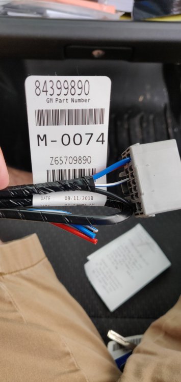

If your truck has the Z82 tow package, check your glovebox. It should have a cable in a plastic bag that connects to the black box behind the pedals. On the opposite side, you plug in to your aftermarket controller. The controller likely has a mounting bracket you can install if you so choose. I would recommend putting it under the dash near the parking brake. Adjust the gain on it until you can press the brake, and make a nice smooth stop from say, 50 mph. Easy.

This it?
  • 5 months later...

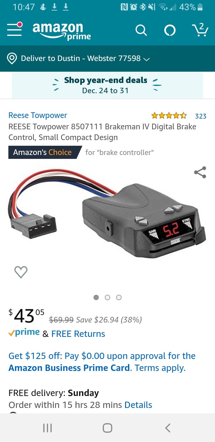

Yea that is it or you can buy one that has a harness already on the open wire end for like $14.
my 2019 trail boss takes prodigy brake controller 90195. You can buy the harness too that connect to your truck and the controller rather than hard wiring the one end.
U can buy a brake controller for like $50 on amazon.  Plug it directly in under dash with the factory adapter.  Super easy.   Hardest part is laying under the dash to mount the thing.  If u dont wanna jack with the brackets get some heavy duty sticky back velcro.
