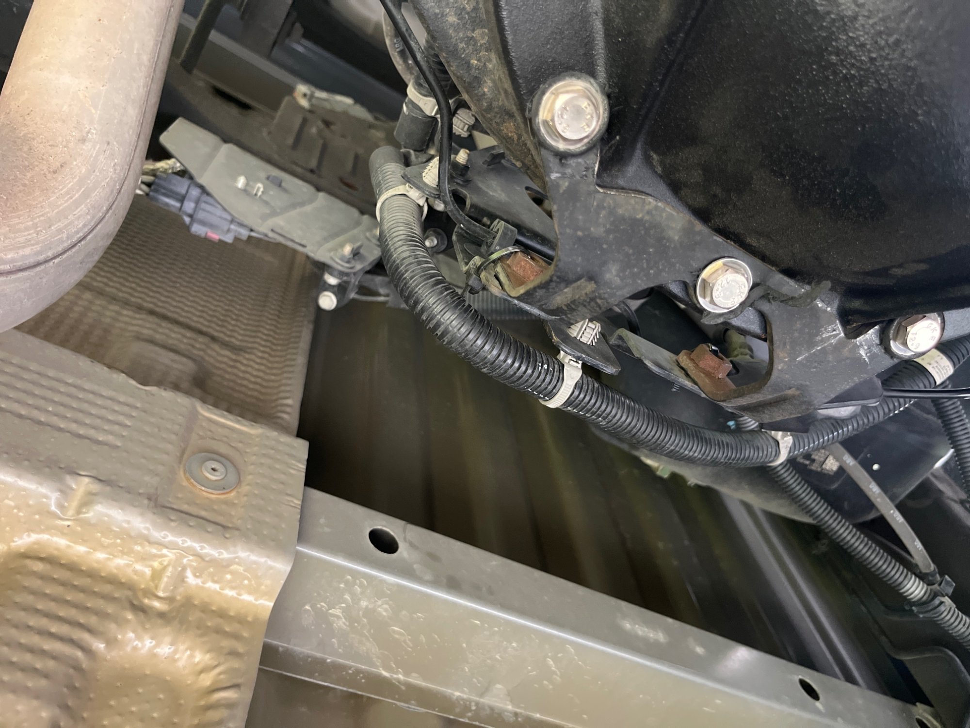

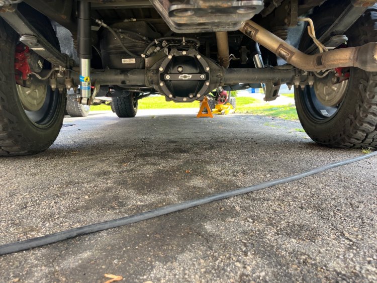

Hey GETGONE, that is the Proform Bowtie diff cover in black crinkle finish. You can get them from Jegs, summit, or Amazon for around $180. This was the one that supposed to fit the 8.5 or 8.6 inch GM differential. They also make them for 7.5 inch and some others, too. I figured I’d give it a shot, and since LUBELOCKER made the reusable gasket for the 8.5” ‘corporate’ 10 bolt, I made a lucky guess that they would fit. Sure enough. Both went on without a hitch. I guess GM 8.5/8.6 and AAM 8.6 use the same carrier, just different internals. It doesn’t leak. I used Teflon tape on all the threads, even the bearing load bolts.
You’ll find that the bracket on top of the diff needs slight modification when you install, the bolt holes don’t quite line up for the two on top due to the new aluminum cover being slightly thicker (3/8”). No problem, couple of cable ties will hold it until I take it back off and elongate the holes about 1/8”. The photo is upside down (thanks, iPhone), but you can see a hint of the cable ties on the bracket where the welded nut is on the bottom.
you’ll need to grind out the inner corners of the bracket that goes on the cover where the ribs of the cover contact it, so the bracket goes on flat. I just took mine to a bench grinder after marking it. After getting it right (no, it’s not that easy and I was up and down several times getting it just right), I was able to follow the bolt pattern on the Lubelocker box (for torque sequence), tightened them all down to 20 ft.-lbs. (bearing load bolts to a max of 10, jam nuts also 10), and installed the drain plug with Teflon tape. Filled with 2 quarts of LucasOil synthetic 75w-90, and put the fill plug in. She’s been a happy camper since.
also, they come in a couple different finish options, too. I got the one that stood out the most to me. I believe you can get natural finish, and matte silver, too (not chrome). Additionally, they send two sets of stainless bolts to use. One is metric (what I used) and one is standard. Both take a 13mm or 1/2” socket.
