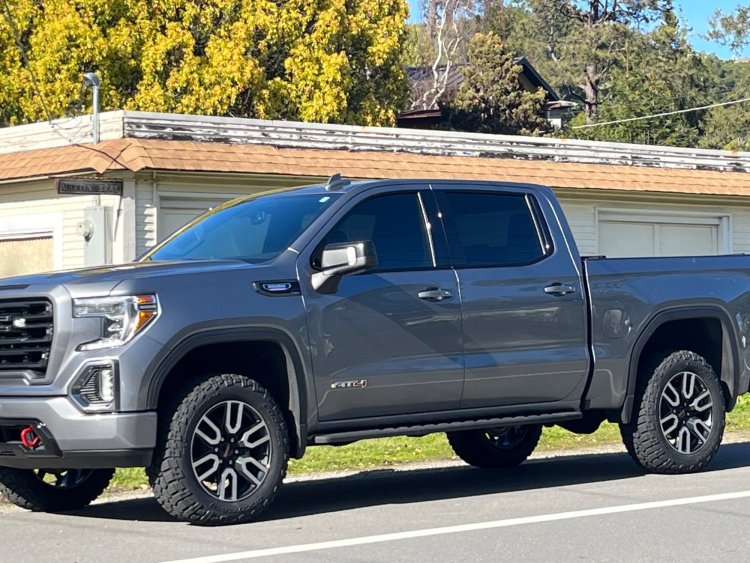

On 3/19/2023 at 11:11 AM, Tdola said:
Anyone have any insight on putting on 35 x 12.5 x 20’s or 22’s on my 2020 High Country? Current set up is FOX 2.5 Coil Overs up front with Reservoirs, Icon Upper front Control Arms,  Fox 2.5’s in the rear with reservoirs with Deavers rear leaf springs and 2” blocks and Fender Delete Kit in the front and the back.  It’s basically a leveling kit that raised the front about 3” but the front was so high that I added a 2” block in the rear to achieve and actual lift of about 1” and level the front with the rear.  I don’t mind trimming what needs to be trimmed at all.  I get so many different opinions on whether or not this can be done.  Reading thru these posts seem to say that it’s totally doable.  Any suggestions would be appreciated.
I would love to see pictures.  I have a similar setup for my 2021 AT4- i just haven't installed it yet.  Everything is sitting in my garage waiting for a warm weekend...  So I have the Fox 2.5s and the Icon UCAs for the front like you, but I opted for Fox 2.0s for the rear.  Honestly, the main reason I went with the 2.0s instead of the 2.5s wasn't because of price, but because I don't want to have to unbolt the bed of my truck when ever the shocks have to be serviced.  I wish Fox had rear 2.5s where the reservoir was mounted directly to the shock like the way Icon does.

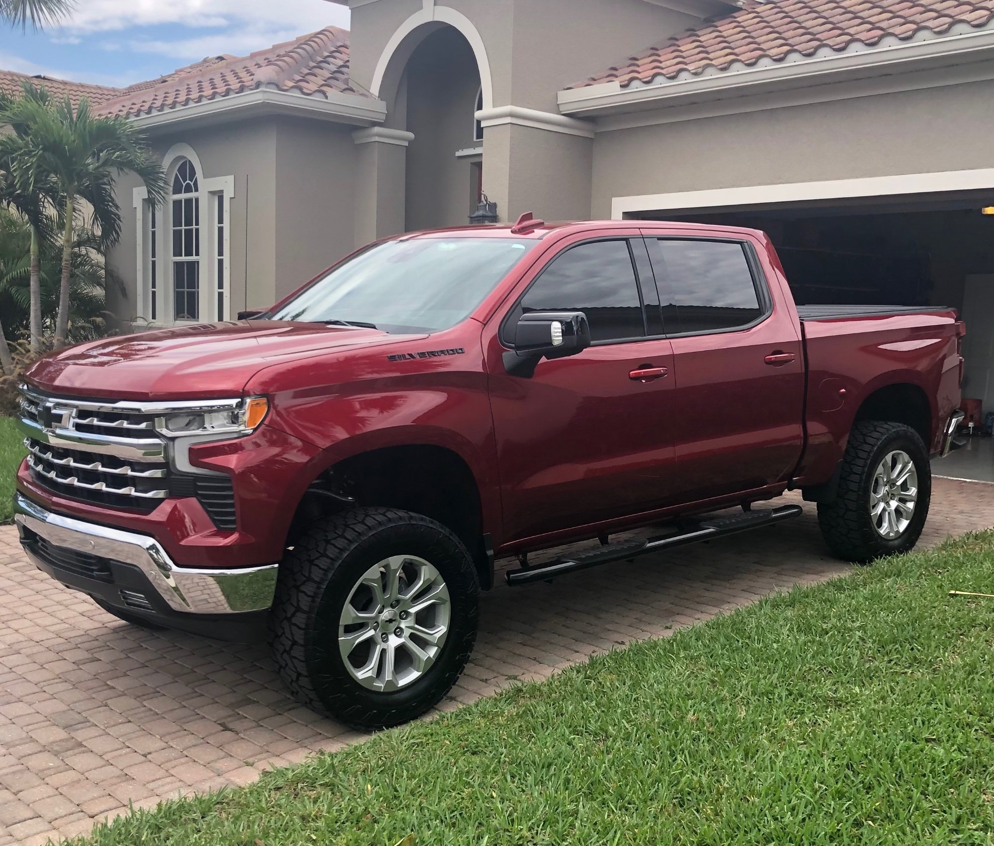

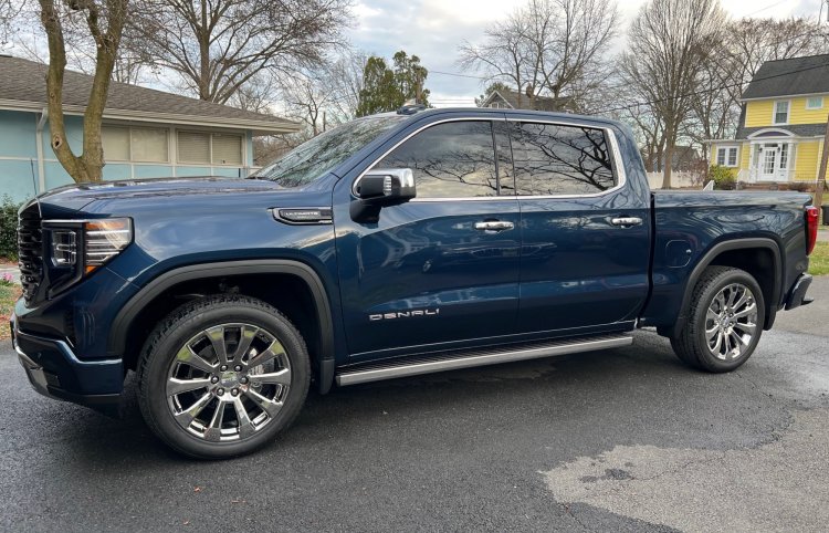

Here you go! 2019-2021 High Country chromed wheels

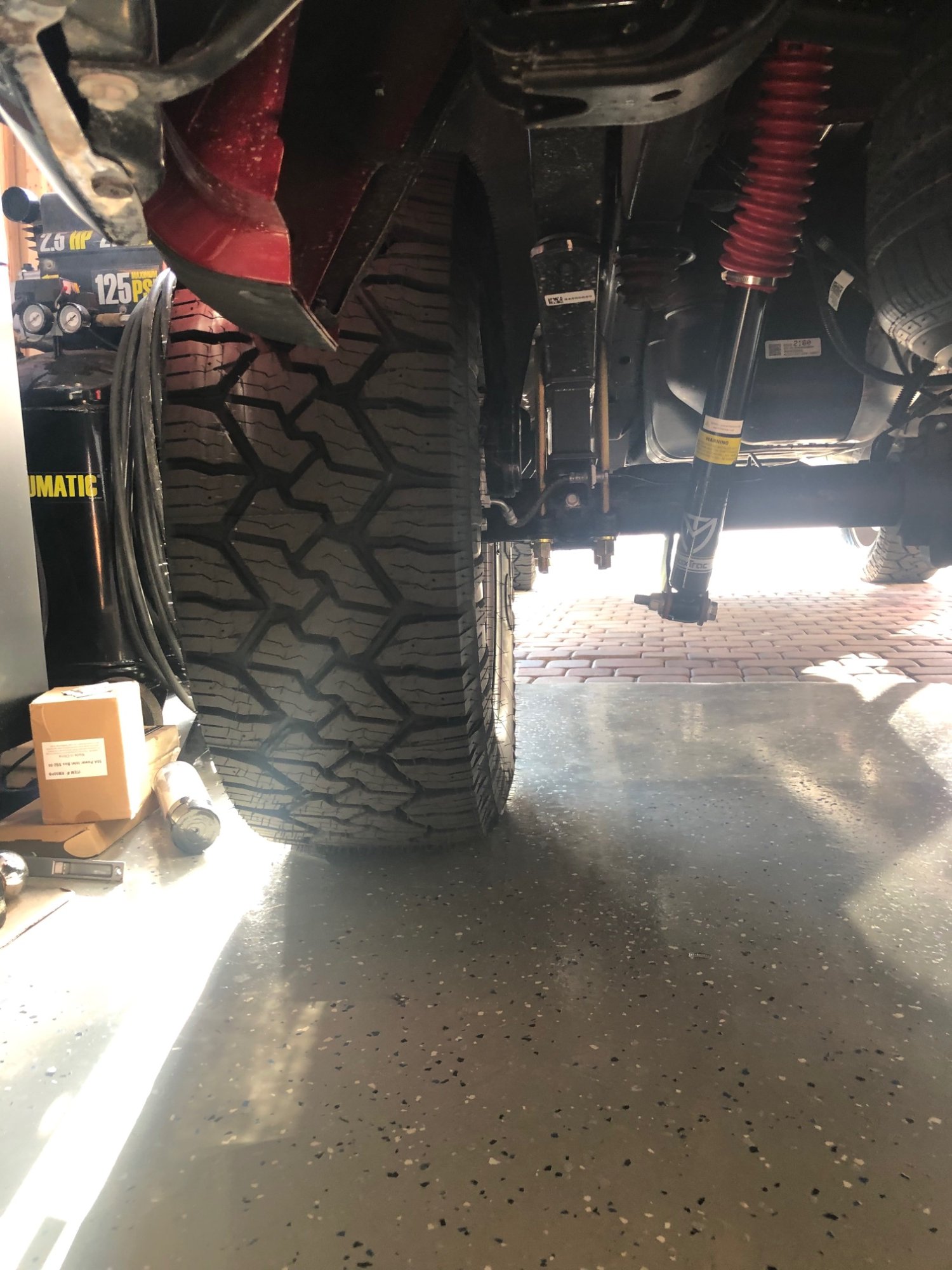

275/65r20 with 2 inch spacers and the at4 factory lift and readylift +2 sst. Exactly 4 inches of lift now after the struts and shocks settled. Upgrading to 35x12.50x17 venom xt soon and pro comp 17.

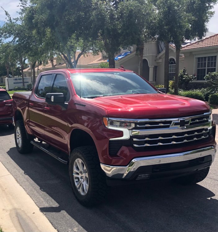

Here is my 2022 refreshed Silverado 1500 LTZ.
3inch strut spacers with 3.5 Maxtrac lift spindles
rear 4 inch blocks. 35x 12.50 R20 AT Nittos.
stock rims 2 inch spacers. Had to trim inner
front wheel wells both sides zero rub.
