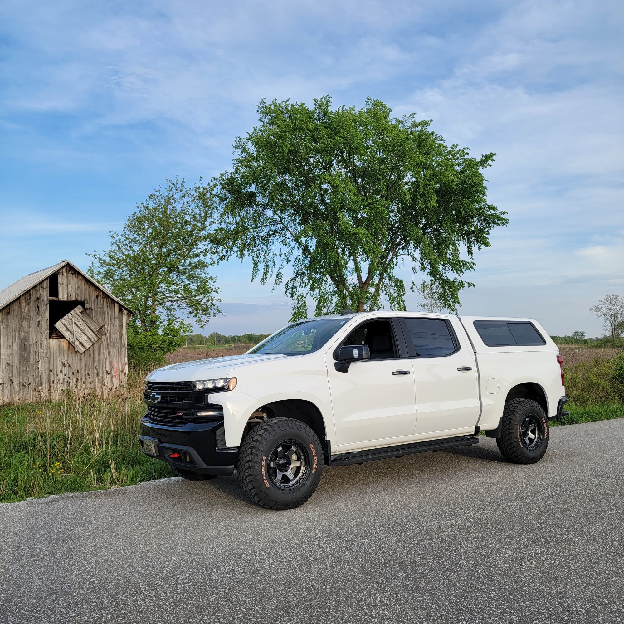

17x9 with -12mm offset and 295/70's. I had to trim the mudflaps fo it didn't rub anymore.
its a trailboss with stock suspension. 2" lift over a standard z71 or 4x4
