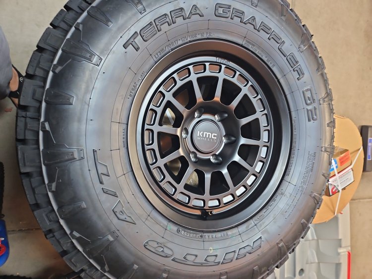

These showed up today. Get them and the lift on this weekend
17x8.5 KMC Canyons with 0mm offset
315/70/17 Nitto Terra Grappler G2s

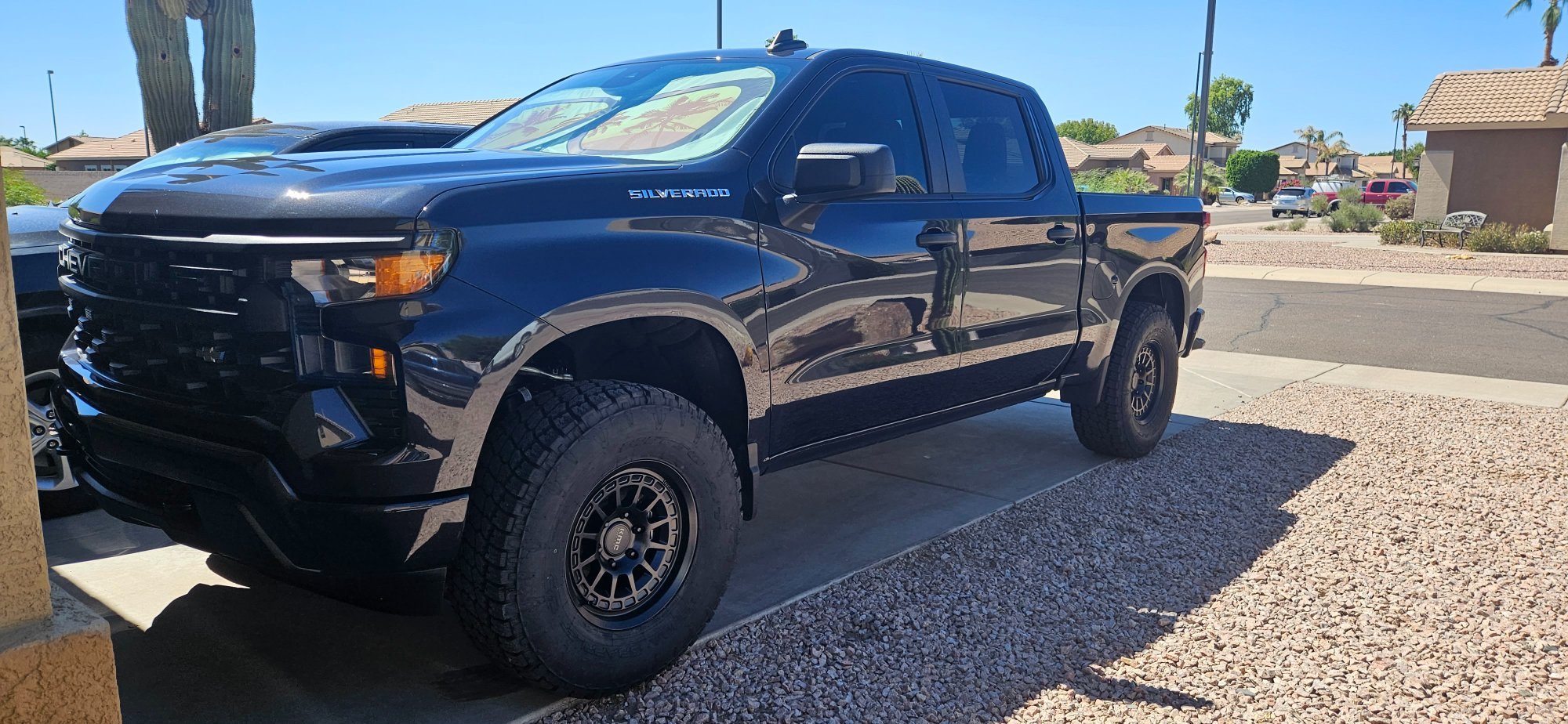

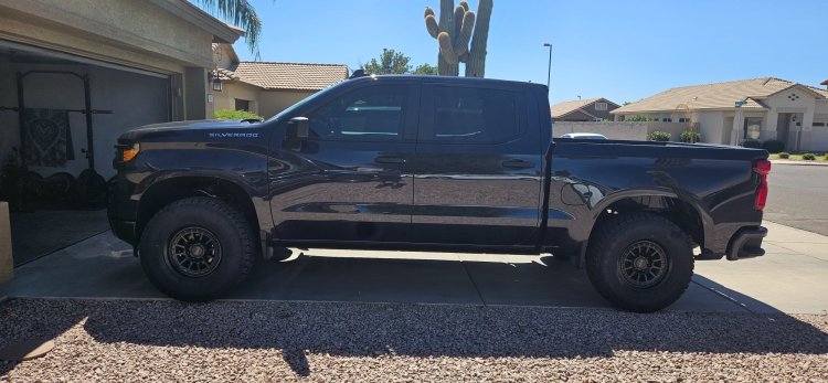

And done!
Little poke, but the spindle pushed it out about 1/4" on top of the wheels offset.
-3" lift spindle
-No spacer needed for caliper.
-Minor trimming of Mud flap and front liner braket
-Running them at 36-38 psi for now
315/70/17 Nittos Terra Grapplers
KMC Canyon 17x8.5, 0mm offset (4.75 BS)

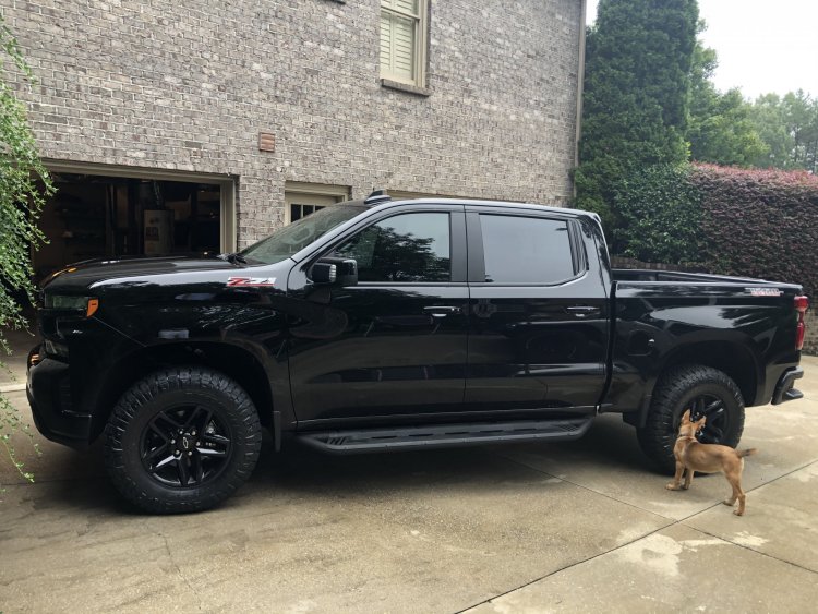

Nitto Ridge Grappler 295 70 18.  No level kit (yet).  Absolutely no rubbing or trimming necessary.
