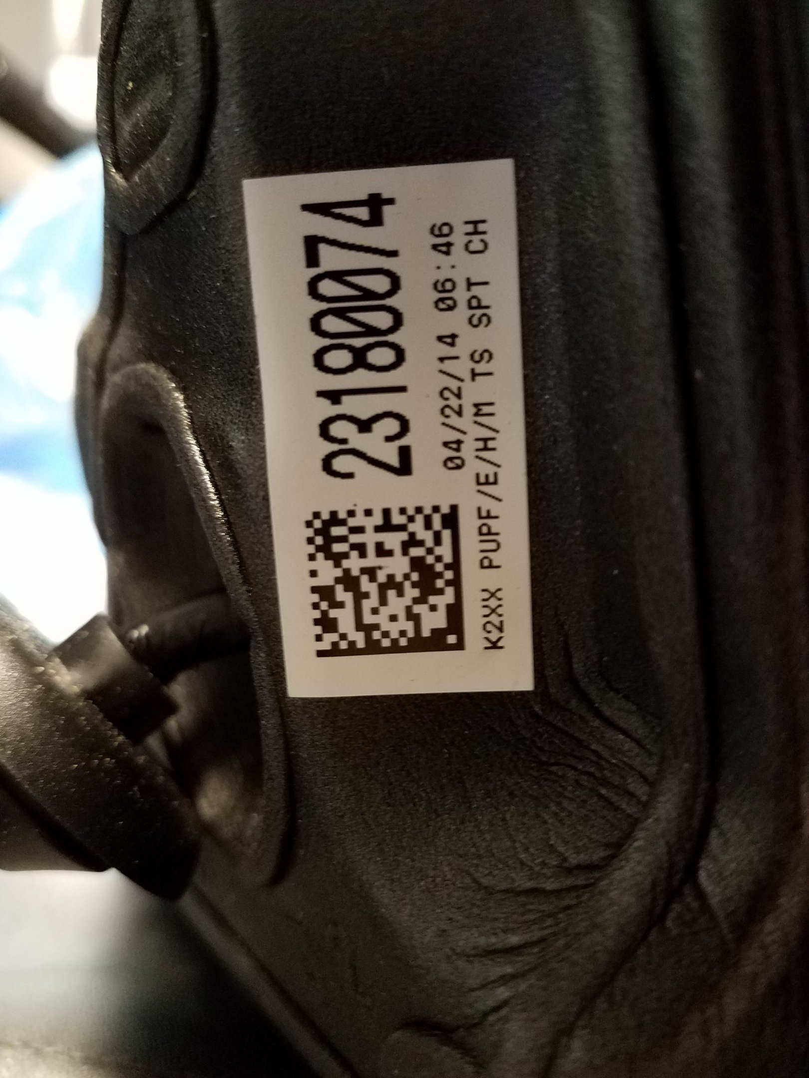

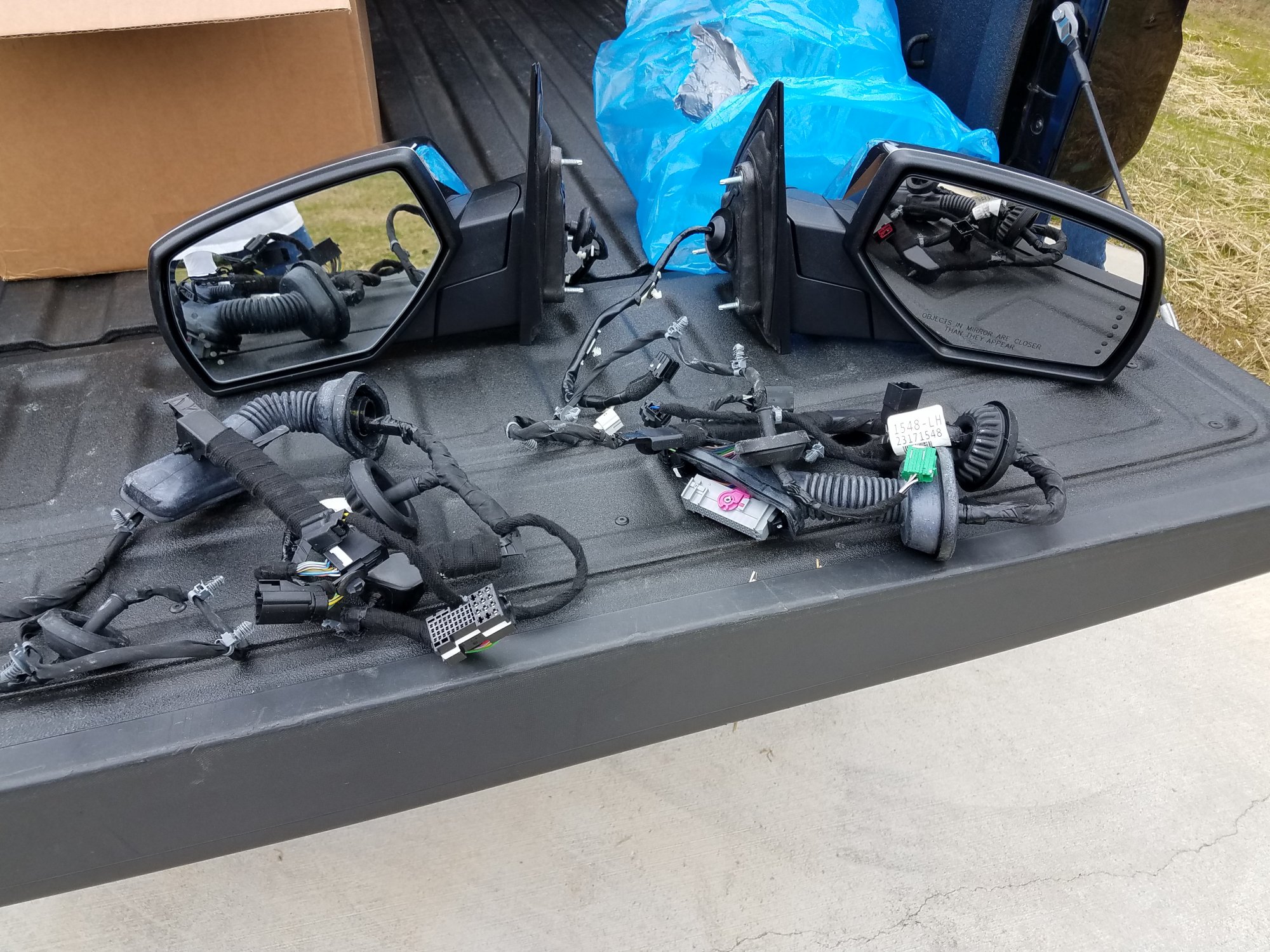

My 2014 has the basic power mirrors with body colored caps. I spotted these on Craigslist. They came off a 2014 that the owner says he swapped out for tow mirrors shortly after he bought the truck.

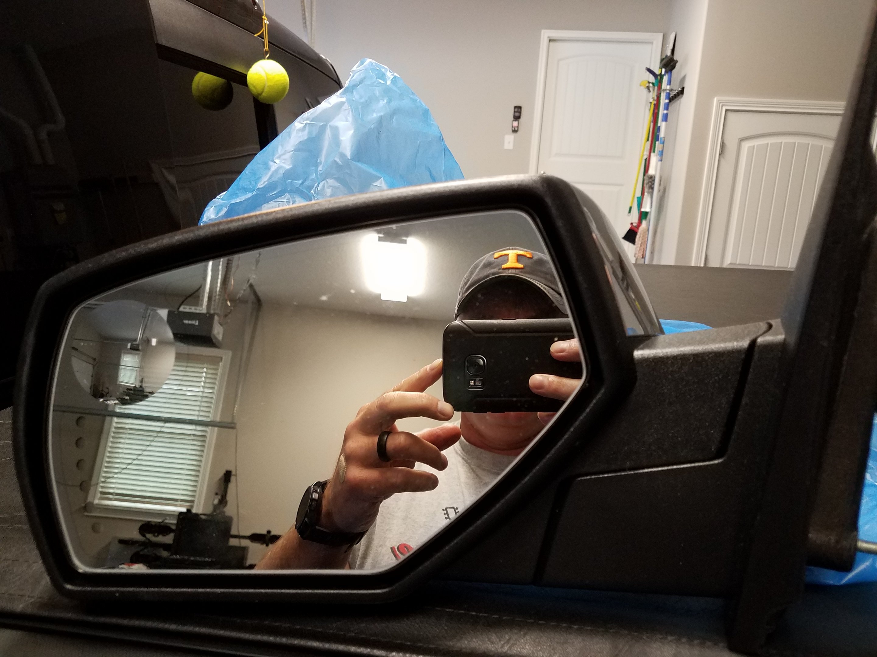

I want to use them on my truck. They have the signal in the mirror and puddle lamps and chrome caps. I want to remove the chrome caps and use my body colored caps. How do I go about removing the caps without breaking them?

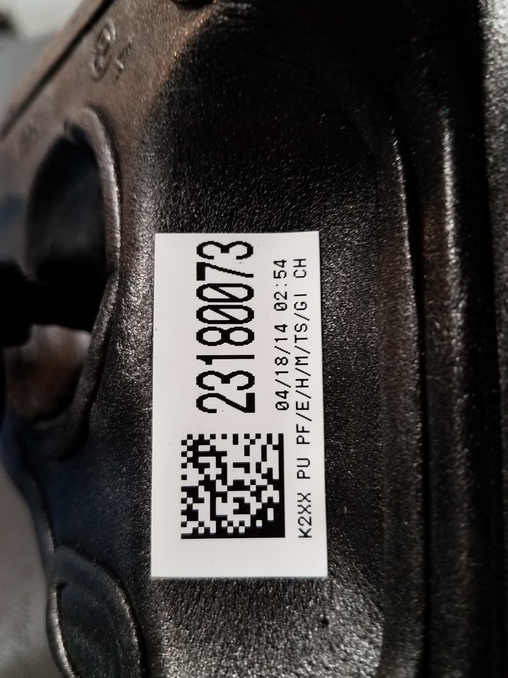

What mirrors are these? I am sure these are not plug and play. What am I going to have to do electrically to make these work with my truck?

You'll need a slim putty knife or butter knife, and gently go around the mirror cap prying it free from the body of the mirror. I started on the outside end.
Just don't pry really hard. If one area feels to be more grabby than another, start at that point.
YouTube has a couple of videos that show it pretty well. Not hard at all to change mirror caps.

Those are DL3s. You'll need new door harnesses and a switch to make them work as they should

$75 for the mirrors and factory harnesses. I need a different harness than the factory one that came with them?
What switch are you referring to?

These are also power fold so you'll need a new switch that has the power fold option. Our resident guru@pgamboa could get you all this, shoot him a message.

Here’s the everything you need to know mirror thread.
As stated Red16 you should get your harness from Phil aka the Harness DR.
I did not know they were power fold also. Cool. I'll send Phil a message and get them set up. Thanks for the link on the mirrors.
