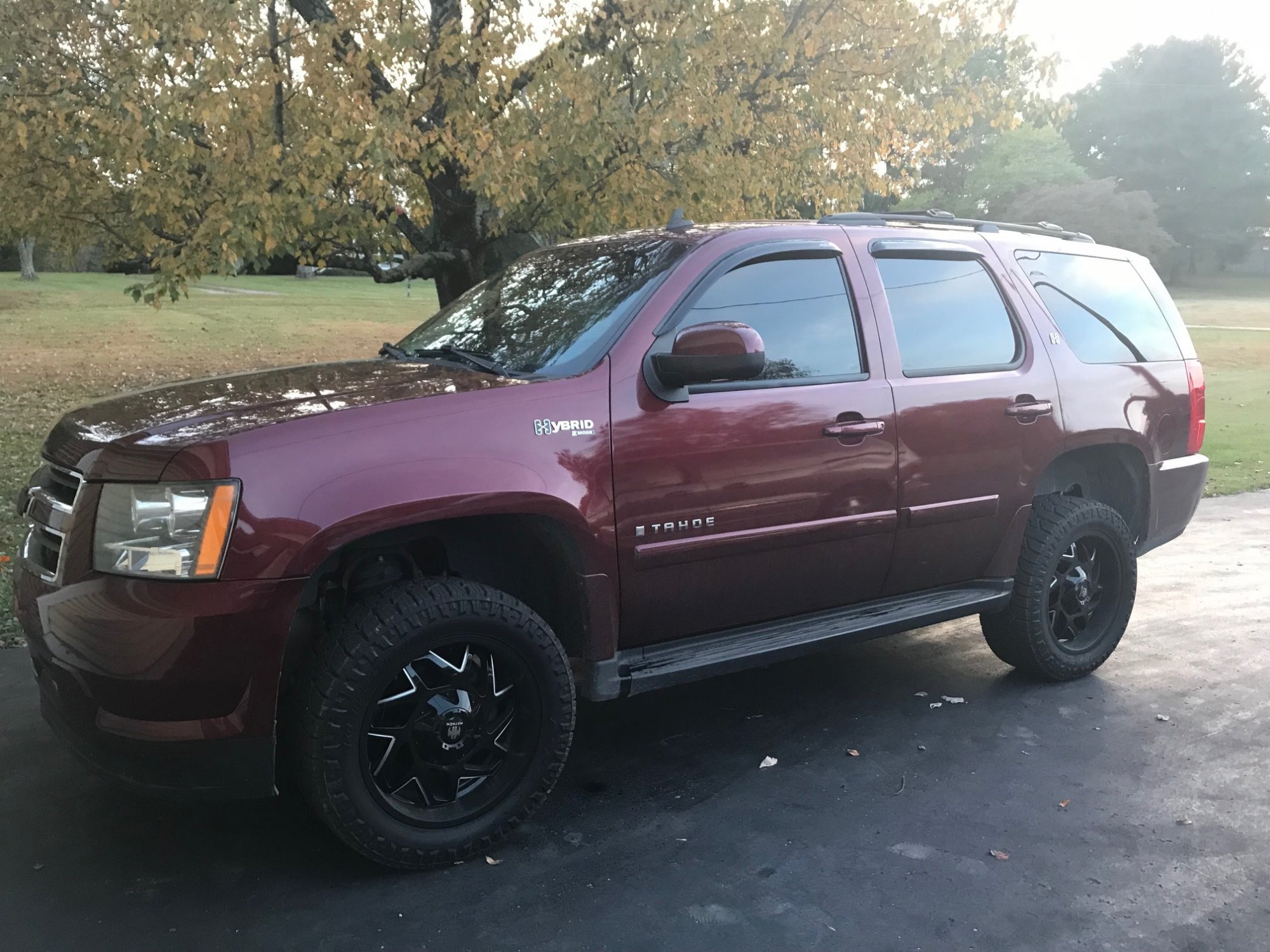

I only have around 150 miles so far but the autostop feature on this 2019 6.2 10spd is a lot more noticeable than in my 2009 Tahoe Hybrid with 217k miles on it. I will have to research how they are restarting the engine in these newer products but whatever it is, it is not nearly as smooth as the Hybrid Tahoe from 10 yrs ago.
It uses the starter in a traditional manner.  Didn't the hybrid use the starter as a motor to move the vehicle and get it going?
The GM TwoMode Hybrids from a few years back utilize 2 electric motors inside the special 2ML70 transmission and use a  dampener in place of the torque converter, it does not have a "starter' in the conventional sense the electric motor inside the transmission spins the engine (aka ICE) through the dampener to start it. The transitions are smooth as silk, really some awesome technology. It was just too expensive for GM to manufacture I guess.
I needed a 4x4 for work and something that I did not have to worry about getting scratched/dented and that was CHEAP to buy. At $6,600.00 this Tahoe fits the bill perfectly and is really a fun truck to drive. I have put 23k miles on it in a year and it has performed well for a "Beater Ride"
I think you are correct on the new GM trucks they seem to be utilizing the regular starter which creates a noticeable shake. i may just turn the silly AutoStop thing off I don't think that I will be able to tolerate it.
